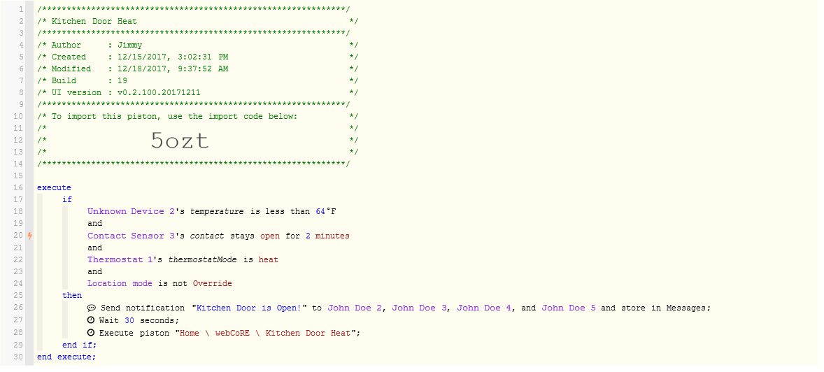

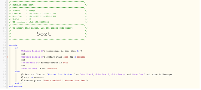

When the door is left opened for 2 mins I want users to get Push messages, that part I have as of now. I also want my Dome Siren to trigger an audible chime that will repeat until the door is closed.
I have figured out the Push alert but pulling my hair out trying to figure out the alert from the Dome siren. I thought I had it figured out but the siren continued to alert even after the door was closed.
This shows my current setup of a Push alert with the trigger to keep pushing until door is closed.
