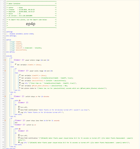

Here’s something you can play with…
05/05/2020, 20:28:34 +432ms
+164ms ║Total time on: 8 minutes and 53 seconds
05/05/2020, 06:15:06 +752ms
+153ms ║Total time on: 4 minutes and 52 seconds

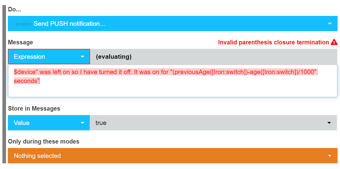

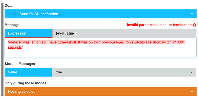

That doesn’t seem to be working for me. I’ve put the following into a push notification where the message is of type “Expression”:
“$device was left on so I have turned it off. It was on for” "(previousAge([Iron:switch])-age([Iron:switch])/1000 "“seconds”
But it’s not picking up the $device or the previousAge formula. What am I missing?
I believe there are too many quotes… Try this slight variation to the Expression:
$device" was left on so I have turned it off. It was on for "(previousAge([Iron:switch])-age([Iron:switch])/1000" seconds”
Hmm with that I get “Invalid parenthesis closure termination” error.
They look well placed to me… Perhaps try running it anyways…
