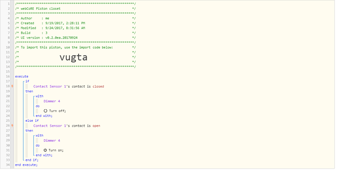

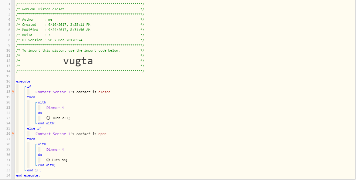

I have a very basic piston to turn on or off a Hue bulb in my pantry, using a door sensor .
Door open =light on
door closed = light off simple eh , but here is the problem .
sometimes the light won’t come on or turn off even though on the ST app sensor open/closed is immediately shown every time without fail ( i’ve stood there opening and closing the door)
I would’ve thought that as the sensor is reporting correctly in the app that the signal to turn on/off the bulb would at least work every time .
Is there anything i can put in the piston to prevent a failure like this
TIA

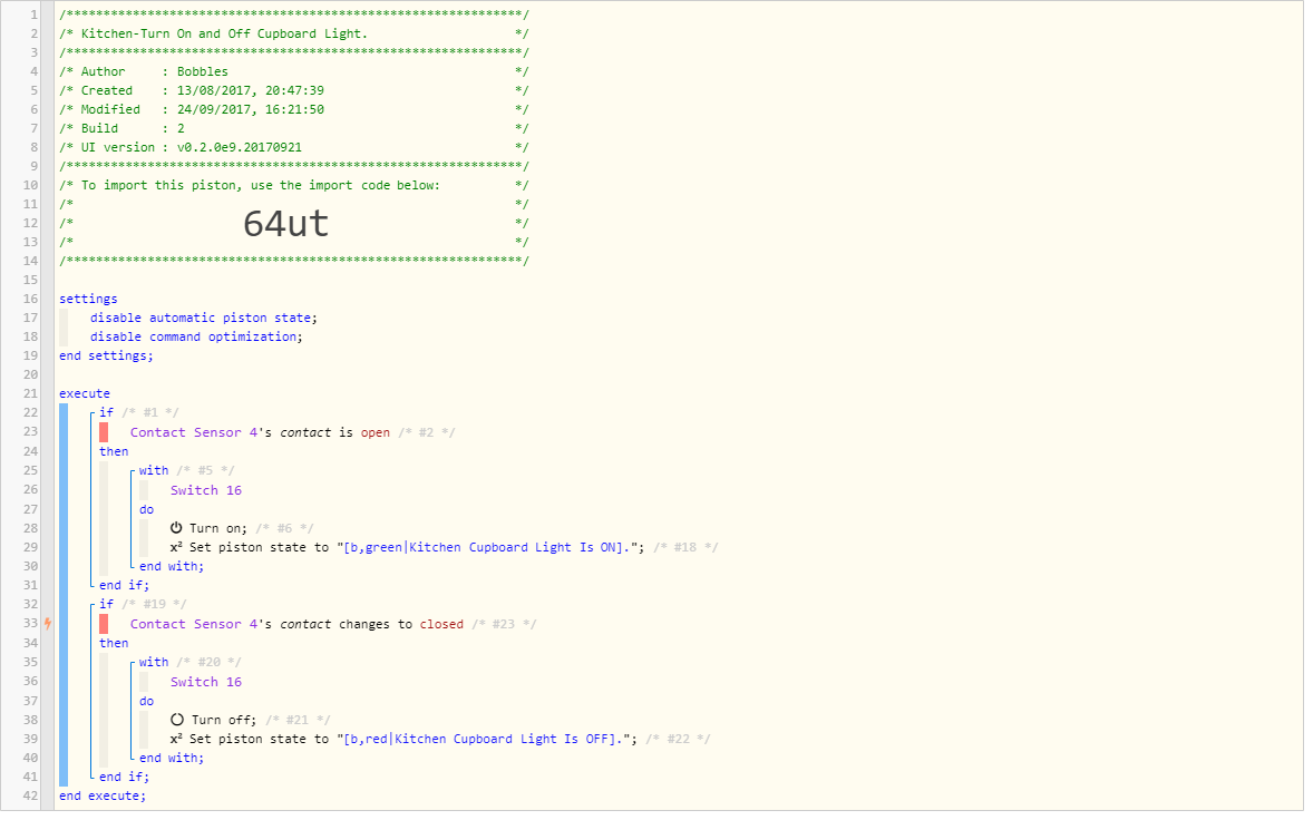

I have a similar simple piston and it works within 0.5secs. Quicker most times.
Please upload a green snapshot.

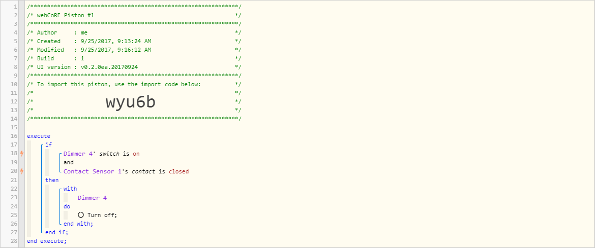

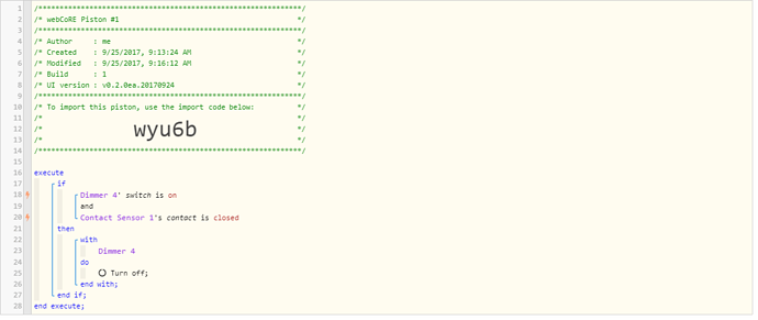

I think i have solved it with this little piston , only time will tell
Edit Nope … back to the drawing board
