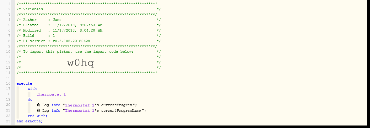

So if I just create a piston to log to info the variables that I am trying to figure out and then test it, will it log the info? I did this and this is in the logs:
+100ms ║║Executed virtual command [EcobeeTherm: Ecobee].log (1ms)
but I don’t see anything else. Where is the log?
The log should be directly below the piston when not in edit mode.
It should add a new line to the log each time the piston fires.
(please post a green snapshot of the piston if it does not)

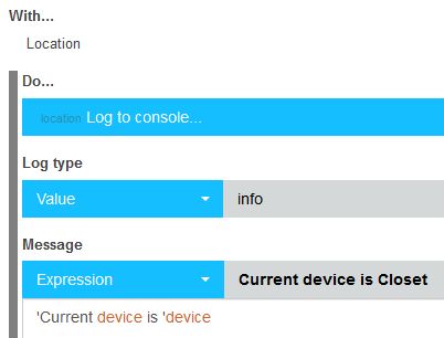

You can see the current info of any device by using this format in an expression box:
[Exact Device name : parameter]
Like this:
Alternatively, for a bit more info, you can enable the console up top:
and then at the very bottom, change to ‘Expression’ and type in the same code there:
