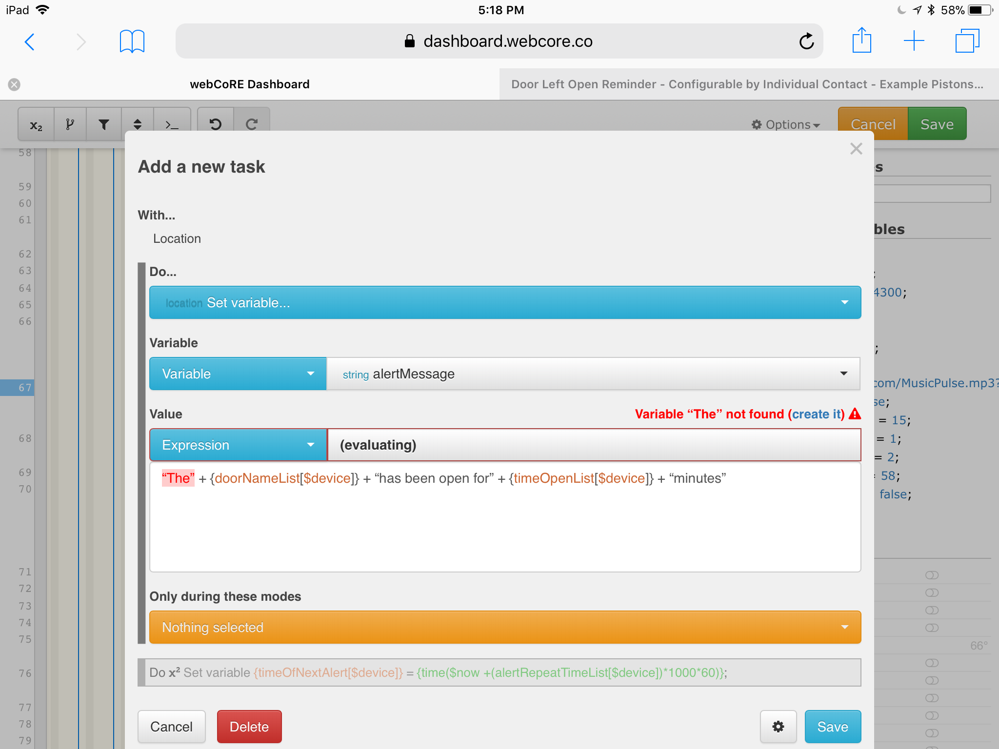

I’m trying to get his expression to evaluate correctly.
Where is my mistake?
TIA
if you remove the does it tell you that has is not a variable?
If so then change all the fancy quotes (“”) to normal quotes ("")

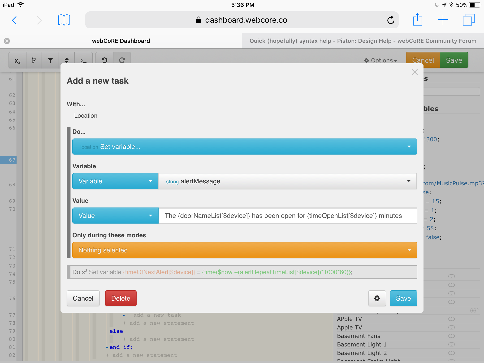

I actually just changed from an expression to a value and got rid of the plus signs and quotes. All good now.
The problem was the fancy quotes. For future reference
