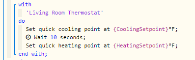

Just curious. When did quickSetCool and quickSetHeat go away in webCoRE? I’ve searched the ST forums and couldn’t find an announcement or anything regarding these going away.
I noticed my thermostats were not syncing with webCoRE anymore (Thermostat A setpoint changes, send change via piston to Thermostat B) and went to investigate to find that where I had used actions for quickSetCool & quickSetHeat, when I went to edit them, those Do functions were blank and those actions were no longer in the list of selectable options. I had to change to set cooling point and set heating point.

webCoRE used to have this do action:
The “Set quick cooling point” and “set quick heating point” options are no longer available. When I clicked on “Set quick cooling point at {CoolingSetpoint}F;”, the do action was blank as if it had been removed from available selectable options in programming, the value was still {CoolingSetpoint}. I clicked the Do action and then was able to set it to “Set cooling point…” and “Set heating point…” respectively.
Like I said, the DTH most likely removed the two. The script still references them, but they are no longer there…
