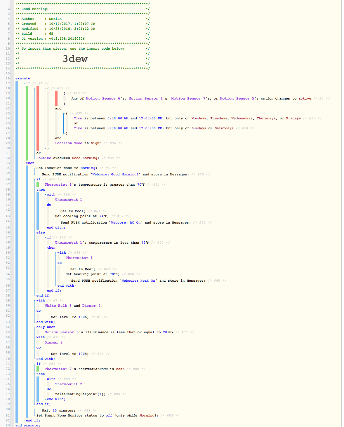

Trying to have my thermostat raise the heating set point by 1 degree, if the thermostat is in Heat mode.
As above.

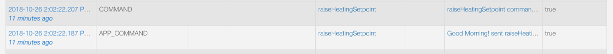

Setpoint not raising. According to logs the command is being sent to the thermostat, but the set point does not change.

+1039ms ║║Comparison (enum) heat is (string) heat = true (2ms)
+1041ms ║║Condition #88 evaluated true (11ms)
+1043ms ║║Condition group #87 evaluated true (state did not change) (13ms)
+1046ms ║║Cancelling statement #89’s schedules…
+1075ms ║║Executed physical command [UPSTAIRS].raiseHeatingSetpoint([1]) (23ms)
+1078ms ║║Executed [UPSTAIRS].raiseHeatingSetpoint (28ms)
