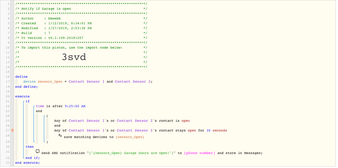

Created a Piston that will send me a notification if a garage door remains open for more than x minutes, after a certain time of the day. If the door is open, send an SMS message. Everything is working, but I get two copies of the message.
Would like to receive just a single SMS. Ideally I would also like to get a second message after the door has been closed, but haven’t figured that out. Might just create a second piston that does that.
I’m getting two messages
1/27/2019, 3:01:07 PM +168ms
+1ms ╔Received event [Home].time = 1548619268416 with a delay of -1249ms
+494ms ║RunTime Analysis CS > 72ms > PS > 401ms > PE > 20ms > CE
+498ms ║Runtime (38657 bytes) successfully initialized in 401ms (v0.3.109.20181207) (496ms)
+500ms ║╔Execution stage started
+517ms ║║Cancelling condition #5’s schedules…
+519ms ║║Condition #5 evaluated true (3ms)
+521ms ║║Cancelling condition #3’s schedules…
+523ms ║║Condition group #3 evaluated true (state changed) (9ms)
+525ms ║║Cancelling condition #1’s schedules…
+526ms ║║Condition group #1 evaluated true (state changed) (15ms)
+531ms ║║Cancelling statement #6’s schedules…
+548ms ║║Calculating (string) Bill’s Side and Krystal’s Side + (string) Garage Doors are Open! >> (string) Bill’s Side and Krystal’s Side Garage Doors are Open!
+1144ms ║║Executed virtual command sendSMSNotification (587ms)
+1306ms ║║Condition #5 evaluated true (1ms)
+1308ms ║║Condition group #3 evaluated true (state did not change) (4ms)
+1309ms ║║Condition group #1 evaluated true (state did not change) (7ms)
+1313ms ║║Cancelling statement #6’s schedules…
+1326ms ║║Calculating (string) Bill’s Side and Krystal’s Side + (string) Garage Doors are Open! >> (string) Bill’s Side and Krystal’s Side Garage Doors are Open!
+1428ms ║║Executed virtual command sendSMSNotification (94ms)
+1432ms ║╚Execution stage complete. (932ms)
+1433ms ╚Event processed successfully (1433ms)
