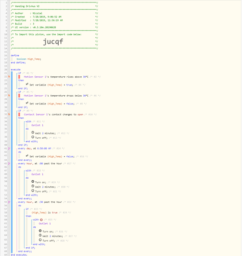

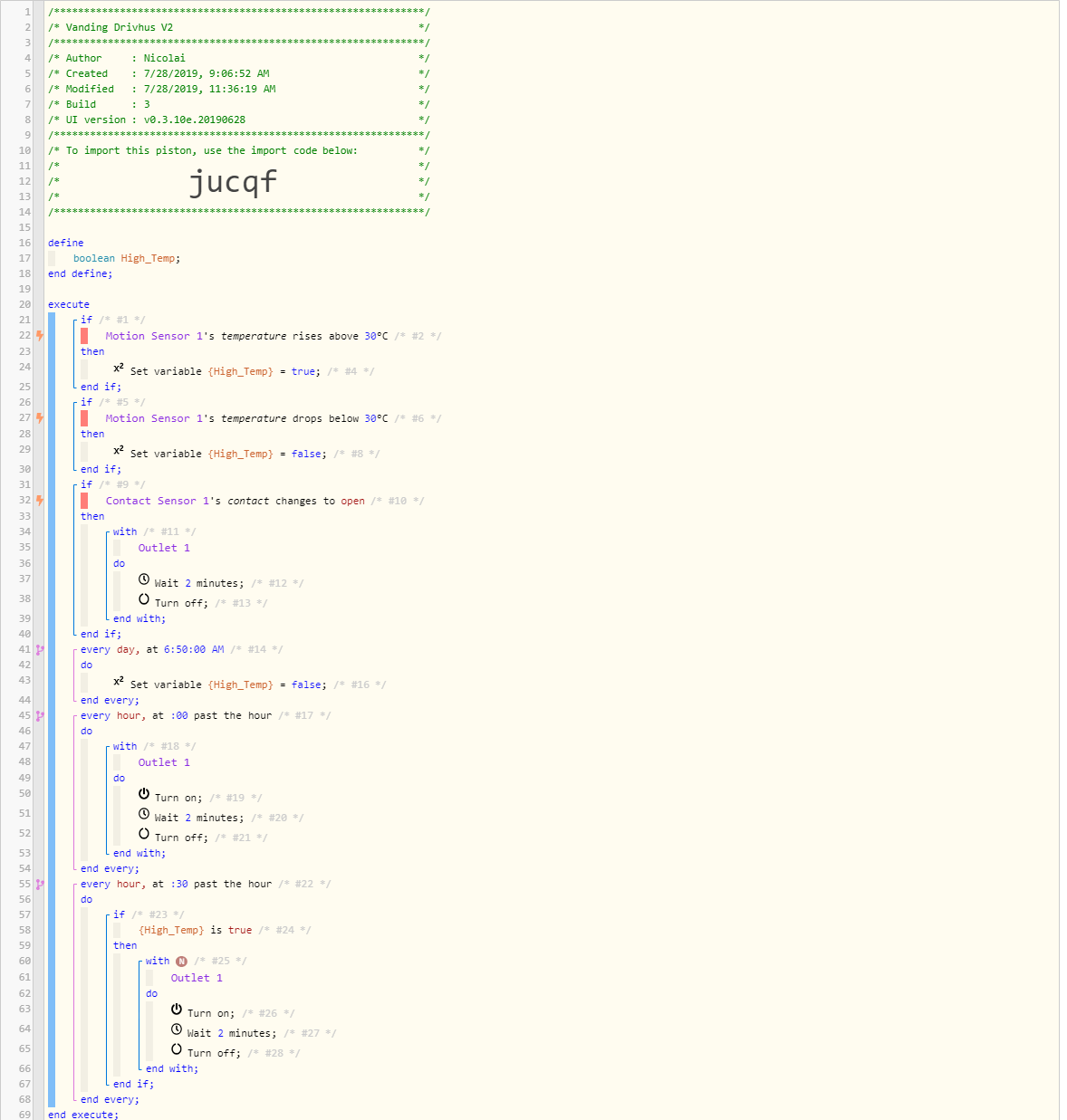

I have a piston that runs a watering routine in my greenhouse. The relays get out of sync with the ST hub. Some times the relays are on but are dispalyed as “OFF” in the App and vice versa. I know that Z-wave is comunication is bi directional. so can’t figure out what is going wrong.
Setup:
Smartthings HUB/Webcore
2 x Fibaro Switch 2
Network healing has been run after last addition of devices. Routing tables should be OK.
Range extender + pluged-in Z-wave devices are present in the signal path to the greenhouse.
The Fibaro Range test output “Green” (Device is communicating directly with the controller)
Smartthings/webcore should be able to turn on/off relays according to Pistons programming.
Seems that Relays/Smartthings/Webcore get out of sync. the relays are turned on, but they never register as being on, when the pistons try to turn off the Relay the the state is falsely registered as OFF so the routine is skipped.

Will the Task Cancellation policy have any effect on the Switch off not being run?
I have a second piston checking in on the relays, this piston will flash the the relay on/off and the turn it off again, if the relay is detected as being on. (Detection via a Door window sensor on a float) This piston seems to catch the problem, but I would rather like the first piston to work all the time.
The Piston run the watering cycle 24-36 times a day (depending on temperature) and fails every 1-2 days. so around 1-3% fail rate.
