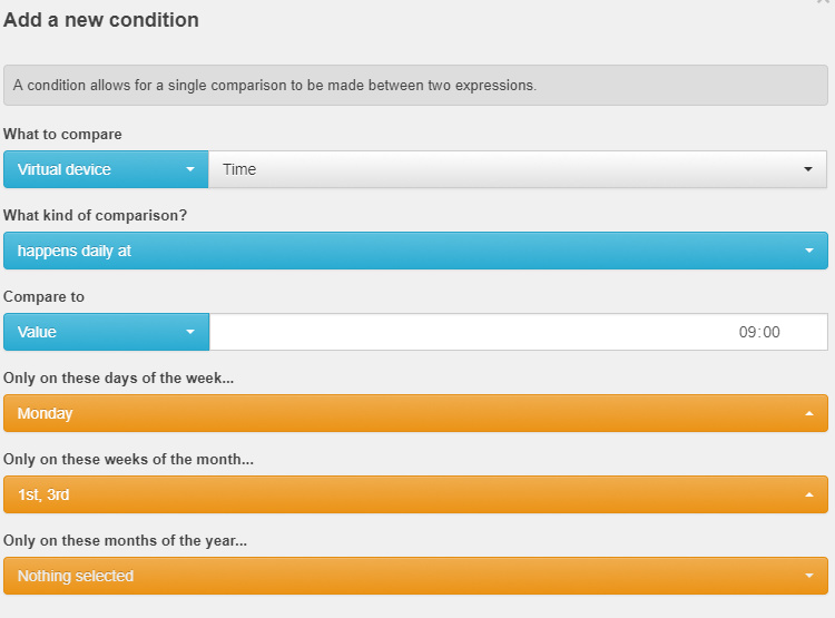

I think so, thanks

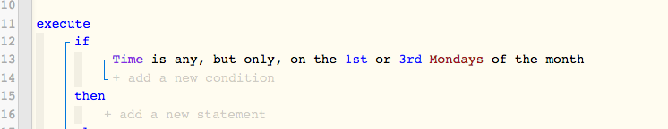

I was using date, but that didn’t populate what you just showed me…
Will this work for what I describe as far as the “if”?

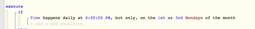

Here’s how I set it up, desiring that only on the 1st and 3rd week, Monday’s only, at 6 PM as the “if”…does this work?
Personally I don’t have anything like this in my set up but you have set up a trigger so in theory your’DO’ should trigger at 6:00PM on the first and 3rd Mondays of the month.
As an aside, what if there is a fifth one. You will end up missing a week.
