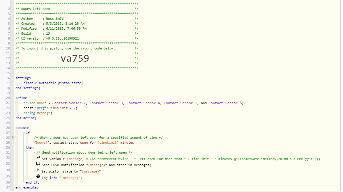

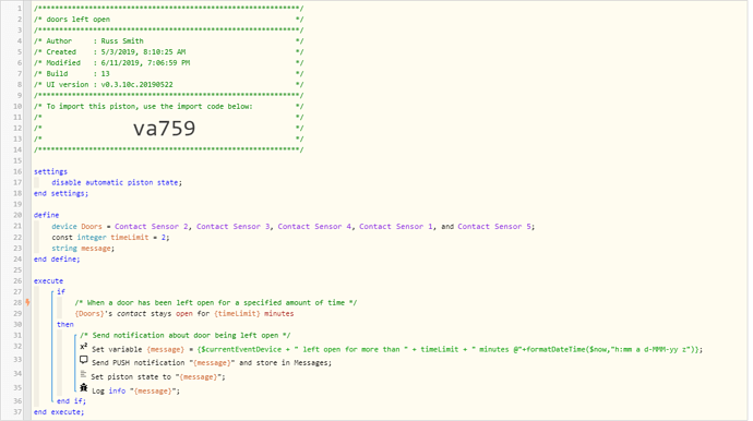

Oddly enough. I have a piston that I wrote to tell me if a door has been open for more than 2 minutes. I expected it to nag me once. I nags me approximately every two minutes that the door is left open. I say approximately because sometimes it takes up to five. Here’s the piston I’m using:
I’m going to work on it today to see if I can get the nag more time-reliable. I’ll let you know.

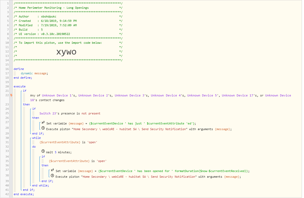

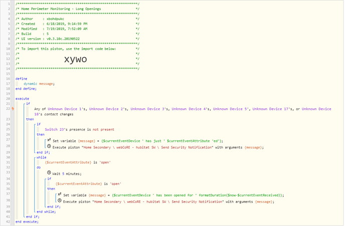

ended up doing this
