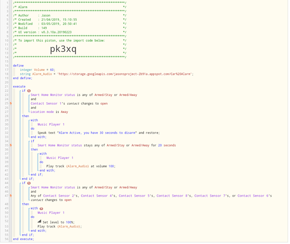

Hi all new here, have been using Webcore now for a few weeks and im loving it. Im not an advance user in anyway so my pistons are very basic but im hoping someone can tell me why a repeat wont work. I have created this piston to trigger an alarm using my google home if the alarm isnt deactivated within 30 seconds or if the alarm is active and any other sensor is opened. Now it works fine except i would like it to repeat the alarm sound if the SHM remains Armed, but everytime i try to add one it it doesnt even sound the alarm once and i have tried wrapping it arround the IF and the WITH and im just not sure what to do.
Hope someone can help
Jason
