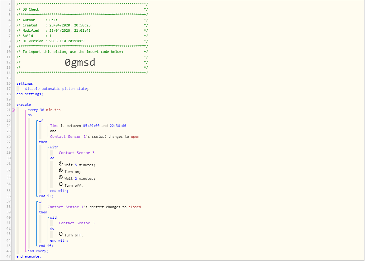

Piston works, but not how I want it to
Constant notifications until change back state.
This piston works in that it detects the open sensor, waits the correct time, and opens the virtual sensor, giving me a notification that the sensor has been open for 5 minutes. But I want it to tell me that it’s STILL open after another 5 minutes, and so on until the sensor closes.
I added the “Repeat” and have tried this at different time lengths, but I think it’s in the wrong place???
I just took a quick look at it and one of the problems is,
1 - every 30 minutes when piston executes, your contact sensor MUST BE in CHANGING TO OPEN state, not 10 seconds after not 10 seconds before which will be almost impossible.
2 - What do you mean at line 41?
is that a real contact sensor or a simulated switch?
With your first if, you wait 5 minutes but you don’t know if the door is still open or not. I would suggest something like this:

At line 41 is the virtual switch
