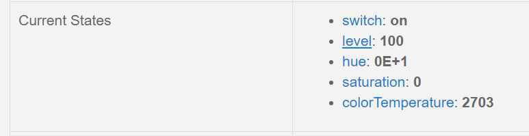

I like the ‘soft white’ color the Amazon Echo sets an RGBW bulb. However, I can’t seem to get WebCoRE to replicate the color. (I change the color of the bulb pretty frequently for alerts - I can’t get the light to go to that color.
Here’s the ‘current state’ from the SmartThings IDE:
Can someone show me how to set a bulb to that color within WebCoRE? I think I’m converting the hue value incorrectly.
Thanks in advance!
Update
For anyone looking to exactly replicate Amazon Alexa’s “soft white” color in WebCore
Set Bulb Color (HSL)
H - 0
S - 0
L - 100
AND
colorTemperature = 2703
