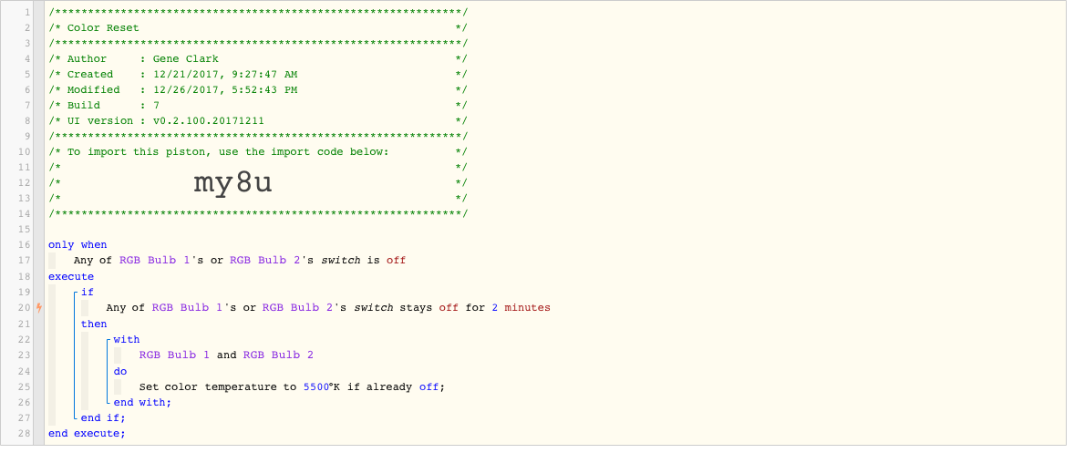

Resetting Light Atteibutes
Piston continues to run when it shouldn’t
I’m trying to reset light temperature back to 5500k after it’s been lit in color. I use SHM with color lighting and would like to reset it back to daylight white while the light is turned off.
Piston is running while light is on even after putting restrictions for it to only run while light is off

Sorry if I’m making a mistake somewhere in this piston but I can’t figure it out.

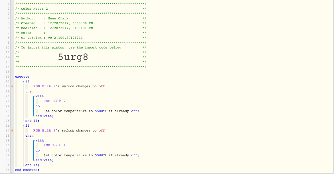

Have you tried splitting this into two IFs, one for each bulb?
That’s was one of the things I’ve done and plus changed from is off to changes to off - not sure how much of a difference that part makes, but it’s working the way I want now. Maybe I should’ve made the changes separately though because I’m not sure which change actually fixed the issue.
