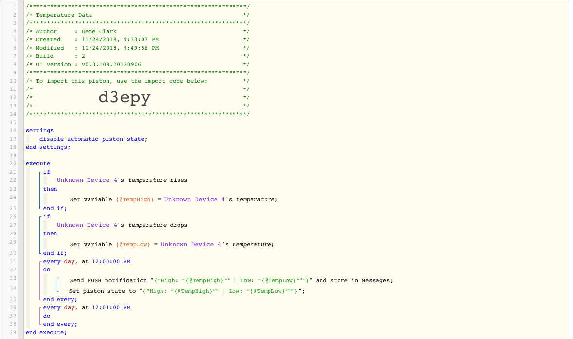

So I’ve got this piston I’d like to keep track of high and low temperatures - morning historical but daily notifications so far. Everyday I’m going to send notifications and set piston state, but also somehow need to reset variables so they capture new temperature data. How can I accomplish this?

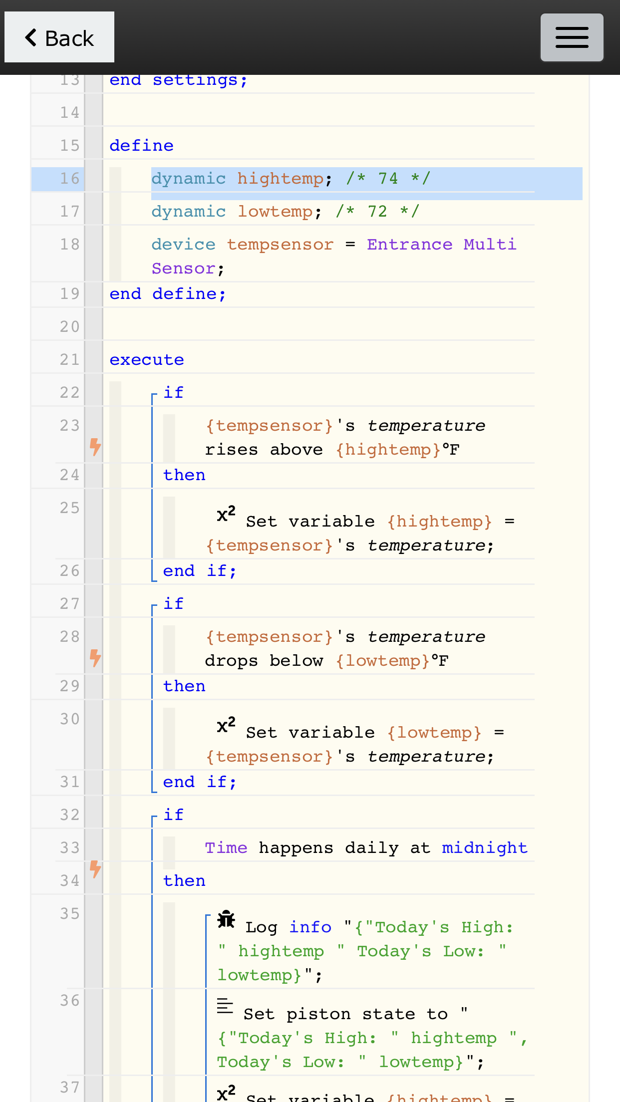

@WCmore So here’s that piston I was trying to do capturing high and low temperatures on a daily basis. Piston B isn’t working whether the variable is decimal or even dynamic. Here’s what it’s showing for today in the variables up top for highs and lows but the actual temperatures are 74.3 for a high and 72.2 for the low so far. How can I fix this?

From what I can see, that looks like a very efficient piston.
(as long as you are ‘resetting’ the variables every day)
Also, now that you added "IF temp rises above variable", you should not use 200 to reset the high, because it will never reach that number, so no new data will ever be written to it.
If it were me, once a day I would probably reset my high variable to 1, and my low variable to 101. This will clear the previous days data, and guarantee that the first data pull on the new day will overwrite it.
As far as why your variables are always whole numbers:
I have noticed in the past that sometimes, when I change a variable from an integer to a decimal at a later time, it remains ‘stuck’ as integers. (even though the piston shows decimal, the stored data may always be an integer) The only solution I found in those cases is to create a new variable with a different name, and assign it as a decimal from the very beginning.
Either that, or some devices only report the temperature in whole numbers.

I think setting high to 1 and low to 101 is flawless as a reset. It clears the old data, and will be over written the very next time the temp comes in. I think it is a great way to make sure the new day’s data is correct, because if those numbers ever come thru in a notification, then you know there is an issue with the piston or data pull.

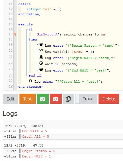

So, if a piston trigger changes state during a WAIT and starts again from the top, do defined variables get reset as well?
Yes, but also, it typically does that even if the state does NOT change…
VERY interesting. I would not have expected that… hmmmm.
Seriously, the number one rule I follow with variables is:
I only define up top IF the variable changes very very infrequently.
(and when it does, I change it manually)
98% of my variables are set inside the body of the piston.
(IE: I want total control of when they change)
