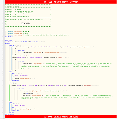

This was copied from another persons example, and worked great for a few months. This piston is duplicating the announce once with the incorrect person, then with the correct.
If someone arrives speak message on specified echo, if someone leaves speak on specified echo.
The logs are detecting the correct person leaving and arriving, but when someone leaves or arrives it is now announcing incorrectly once, then a moment later the correct announcement

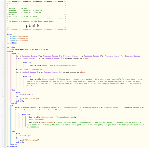

It helps to include a green snapshot with TRACE turned on. This adds numbers to the end of each line that matches up with the log.
I do not see this code anywhere in your piston, so you must have made changes to your piston since the snapshot and the log…

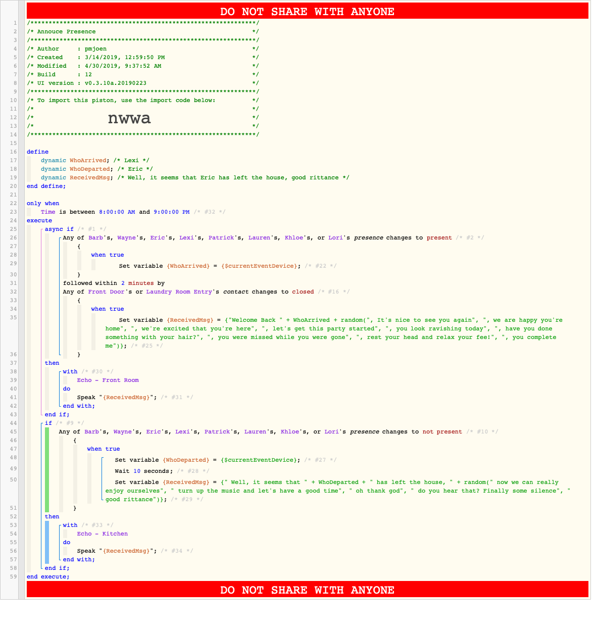

I will re-look at your piston when you’ve posted a matching log & snapshot (w/Trace).
It makes debugging so much easier.
I currently suspect deleting the WAIT on line 49 (or moving it lower in the code) will resolve it.
(Due to your ASYNC)

Thanks for the update… I think my hunch is correct.
I would move the WAIT down a bit - Somewhere below the “Set variable {ReceivedMsg}” on line 50. It is ok to wait before the Speak command, but you want to set that variable as soon as possible.
I believe all this is because you have “when true” on line 47.
Using “when true” with a WAIT can make things happen out of order…
(which is why it’s speaking the old variable first)
Normally, I would code that last block like this:
IF any of X, Y, Z changes to not present
THEN
    Set variable 1, set variable 2, wait, speak
END IF
I removed the wait, Ill see if that works (Not sure why I added the wait)

Well, it took Lauren 3:13 to close the door, so the Speak should not have executed…
… but …
It actually still spoke the old variable 2 minutes after she arrived. (she was still outside and likely did not hear the alert)
I would avoid using “WHEN TRUE” whenever possible, and use normal IF, THEN commands instead.
Specifically, line 35 should move down a bit inside the THEN section. (before the Speak)
Also, it is important to note that your “followed within 2 minutes by” is not checking the door. The Speak command (using the old variable) is executing two minutes after Lauren came home, regardless of the door’s status.
