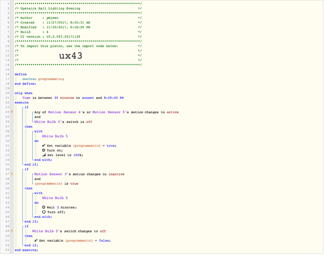

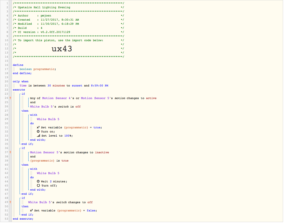

I have tried to use the examples on the forum, but for some reason the lights never turn off after the wait on motion inactive. Please help…
Try using ‘IS’ instead of ‘changes to’
‘Changes to’ only stays true for a short while and then returns to false ready for next trigger, which cancels the wait.
what is really odd was I was able to recreate and see it working on another light today.
