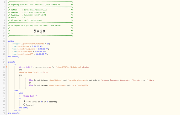

[Resolved] Time is NOT between condition
I don’t think the piston execution is not paying attention to the time “NOT’ in between range condition
When the Side Hall Lights switch stays on for longer then 15 minutes
and
we did not arrive home late (Global Variable called @arrive_home_late)
and
 Time is not between 6:30am and 8:30am but only Mon., Tue., Wed., Thr., Fri.,
 Or
 Time is not between 5:00pm and 11:00pm.
Note: for testing I am using Local variables, but these will be changed to Global Variables that I use in other pistons
Regardless of the conditions
Or
the Side Hall Light is turn off after 15 minutes.
**4) Post a Green Snapshot of the piston!!

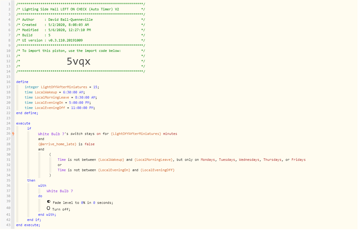

Well… 7:20am is not between 5pm and 11pm, so your piston did exactly what you programmed it to. Maybe try splitting those two time conditions into indented IFs?
(although you may get lucky changing the “OR” to an “AND” on line 32)
@WCmore thanks for the reply!
My thinking was that 7:20am was been 6:30am and 8:30am the first time condition on a Wednesday… so I couldn’t understand why the light was turn off.
But let me try your “AND” instead of “OR” idea. Then I will try two separate indented ifs.
A good way to look at is that each line is evaluated independently, one by one…

Thanks @WCmore this was just a case of me not using my “and” and “or” correctly. I had it in my head this need to be an "or’. Works great now!
