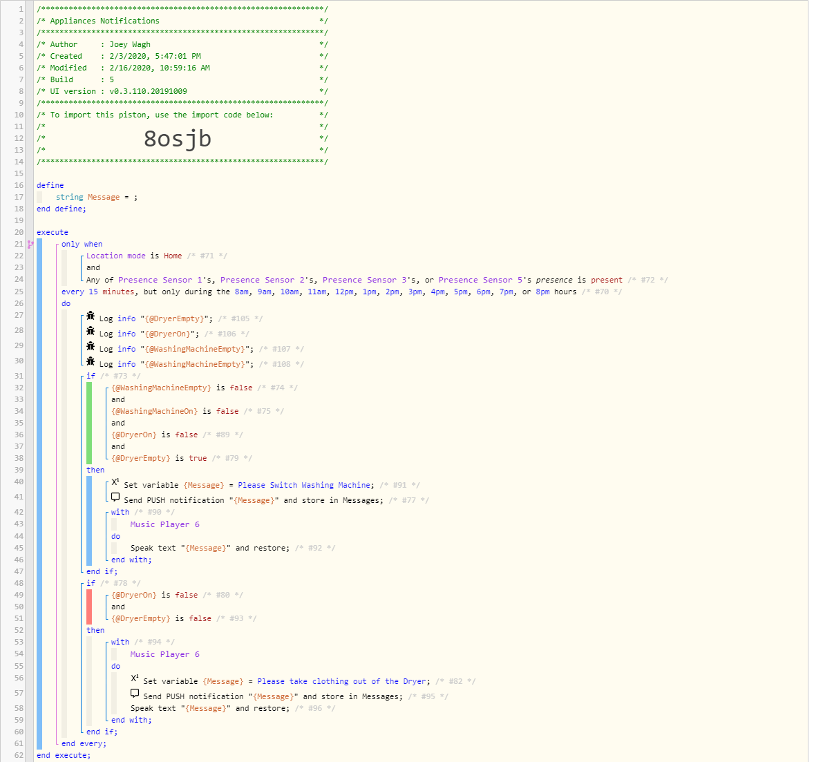

I have a restriction on a DO EVERY. Even though the restrictions are not true, it is still running the code in the DO EVERY.
I would expect the DO EVERY not work if the restriction code is not valid
The code inside the DO EVERY is running
Currently the house is AWAY and no one is home. Yet the code is running.
2/18/2020, 11:44:18 AM +123ms
+0ms ╔Received event [Home].time = 1582044258812 with a delay of -689ms
+133ms ║RunTime Analysis CS > 29ms > PS > 44ms > PE > 60ms > CE
+136ms ║Runtime (44738 bytes) successfully initialized in 44ms (v0.3.110.20191009) (134ms)
+146ms ║║Cancelling statement #104’s schedules…
+151ms ║║true
+152ms ║║Executed virtual command log (1ms)
+157ms ║║false
+158ms ║║Executed virtual command log (1ms)
+163ms ║║false
+164ms ║║Executed virtual command log (1ms)
+168ms ║║false
+169ms ║║Executed virtual command log (1ms)
+175ms ║║Comparison (boolean) false is (boolean) false = true (1ms)
+176ms ║║Condition #74 evaluated true (4ms)
+180ms ║║Comparison (boolean) false is (boolean) false = true (1ms)
+182ms ║║Condition #75 evaluated true (4ms)
+186ms ║║Comparison (boolean) false is (boolean) false = true (2ms)
+187ms ║║Condition #89 evaluated true (5ms)
+191ms ║║Comparison (boolean) true is (boolean) true = true (1ms)
+192ms ║║Condition #79 evaluated true (4ms)
+193ms ║║Condition group #73 evaluated true (state did not change) (22ms)
+195ms ║║Cancelling statement #103’s schedules…
+198ms ║║Executed virtual command setVariable (1ms)
+221ms ║║Executed virtual command sendPushNotification (19ms)
+224ms ║║Cancelling statement #90’s schedules…
+316ms ║║Executed physical command [House Speakers].playTextAndRestore([Please Switch Washing Machine]) (85ms)
+317ms ║║Executed [House Speakers].playTextAndRestore (87ms)
+324ms ║║Comparison (boolean) false is (boolean) false = true (2ms)
+325ms ║║Condition #80 evaluated true (5ms)
+329ms ║║Comparison (boolean) true is (boolean) false = false (1ms)
+330ms ║║Condition #93 evaluated false (4ms)
+331ms ║║Condition group #78 evaluated false (state did not change) (11ms)
+334ms ║╚Execution stage complete. (197ms)
+335ms ║Setting up scheduled job for Tue, Feb 18 2020 @ 11:59:18 AM EST (in 900.355s)
+343ms ╚Event processed successfully (343ms)
