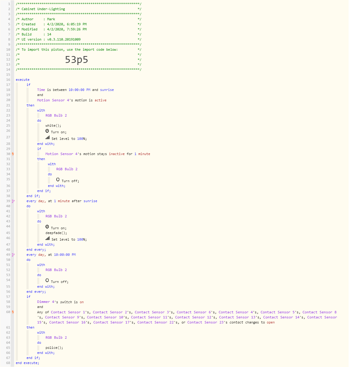

Cant figure out how to stop a light behavior after turning on conditionally.
At the end of the script I have added instruction to make my leds flash like police when a contact sensor opens when the alarm is set to on
everything is working I just don’t know how to make them return to the previous state.
