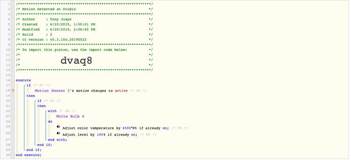

I have one piston that switches my outdoor light on at 10% and 2700K between sunset and sunrise. I have created another piston (see below) that if motion is detected in my Arlo camera to change the light if on to 100% and 5500K.
What I would like to be able to do is set the light back to the original state after 2 minutes of no motion and I am not sure where or how to add that statement.
Set lights back to original state

If you want to go back to 10% and 2700K, if it’s that simple, YES you can just add another IF block.
IF MOTION SENSOR 3 STAYS INACTIVE for 2 MINUTES
Then White bulb 4
Adjust to this and that.
Note 1: Line 20 is an empty IF statement…
Note 2 : One light bulb is monitored by several pistons may cause problems and confusion as your system/house gets more complex FYI.

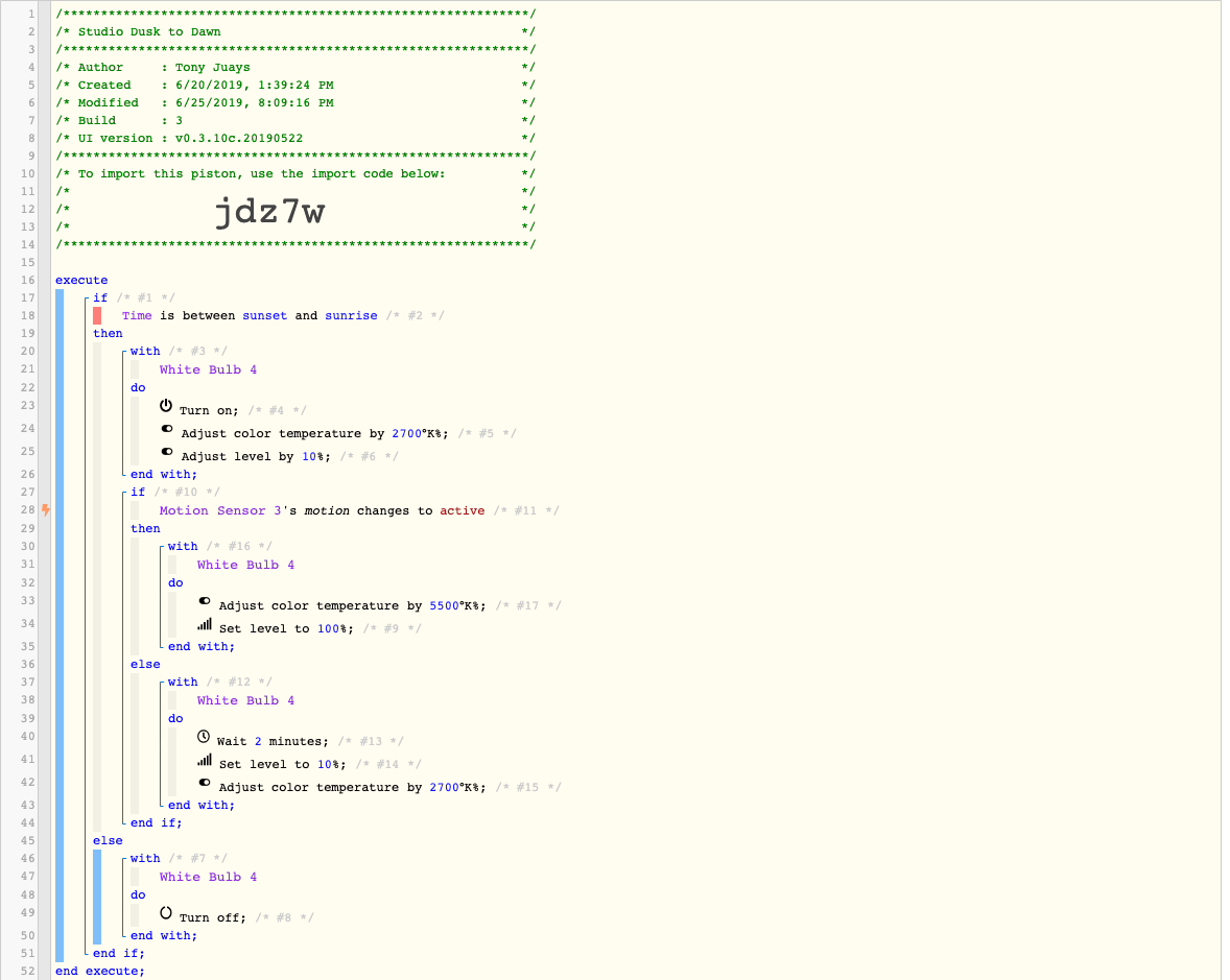

So I reworked my Dusk to Dawn piston to include the motion detection. Now for some unknown reason the light is not switching off after dawn. Would you mind taking a look at it? My assumption is that if the 1st condition is not met i.e. between sunset and sunrise then it would go to the Else to turn the light off.
Thanks again
Tony
I would write your piston more like this:
I personally avoid using ELSE…
Everyday at sunset (Timer or IF)
Turn Light bulb 4 ON
Set level to %10
Set temp tp 2700
Everyday at sunrise (Timer or IF)
Turn Light bulb 4 OFF
IF motion sensor 3 motion changes to ACTIVE
      IF time is between sunset and sunrise (IF within IF)
      With white bulb 4
      Turn On
      Set level to 100
      Set temp to 5500
IF motion sensor 3 motion stay inactive 2 minutes
      IF time is between sunset and sunrise (IF WITHIN IF)
      With white bulb 4
      Set level to 10
      Set temp to 2700
