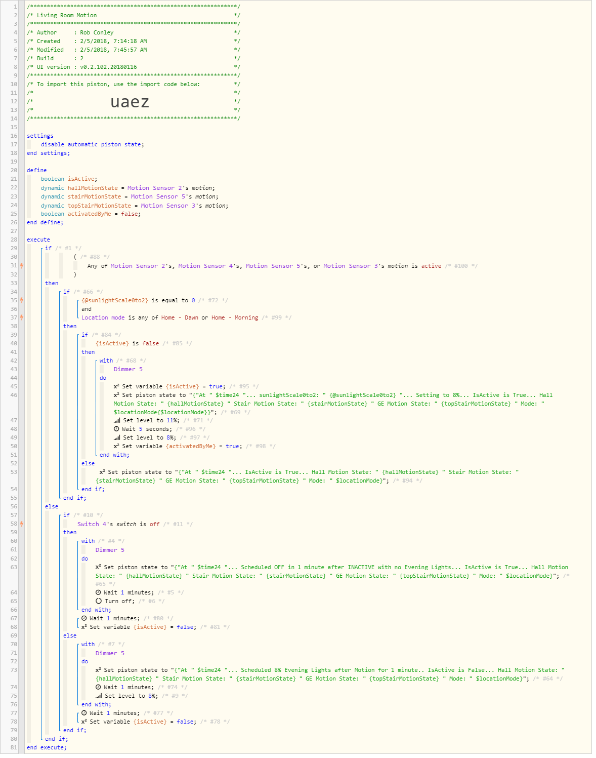

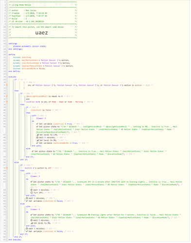

If 3 motion sensors can turn a light on, how do I make sure that only 1 turns it off?
Return light to original state if turned on by any sensor, but only in the morning
Not sure how “inactive” states are handled when multiple motion sensors are capable of turning the light on. I want the light to go back to its original state after all sensors are quiet. This piston hasn’t been tested, I’m just unsure how to approach this problem using multiple sensors and I ran into similar conceptual issues with handling events in another piston. This time I thought I would ask about doing it the right way.
