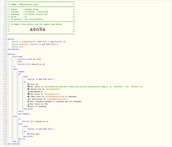

RGBW light does not turn off when zwave light turns on
The RGBW light does not turn off when Den Light is on
If Den light is off, turn off the RGBW light
The RGBW light doesn’t turn off. When I add an else or separate If Den light is on, turn off the Den light turns on then off in several seconds (so I removed that from this piston). Also, I am aware of the error from the Den Wemo switch since it cannot do any of the items the RGB light can do.

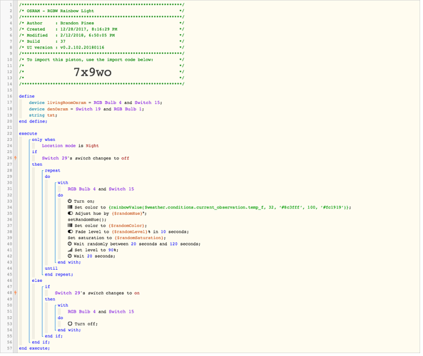

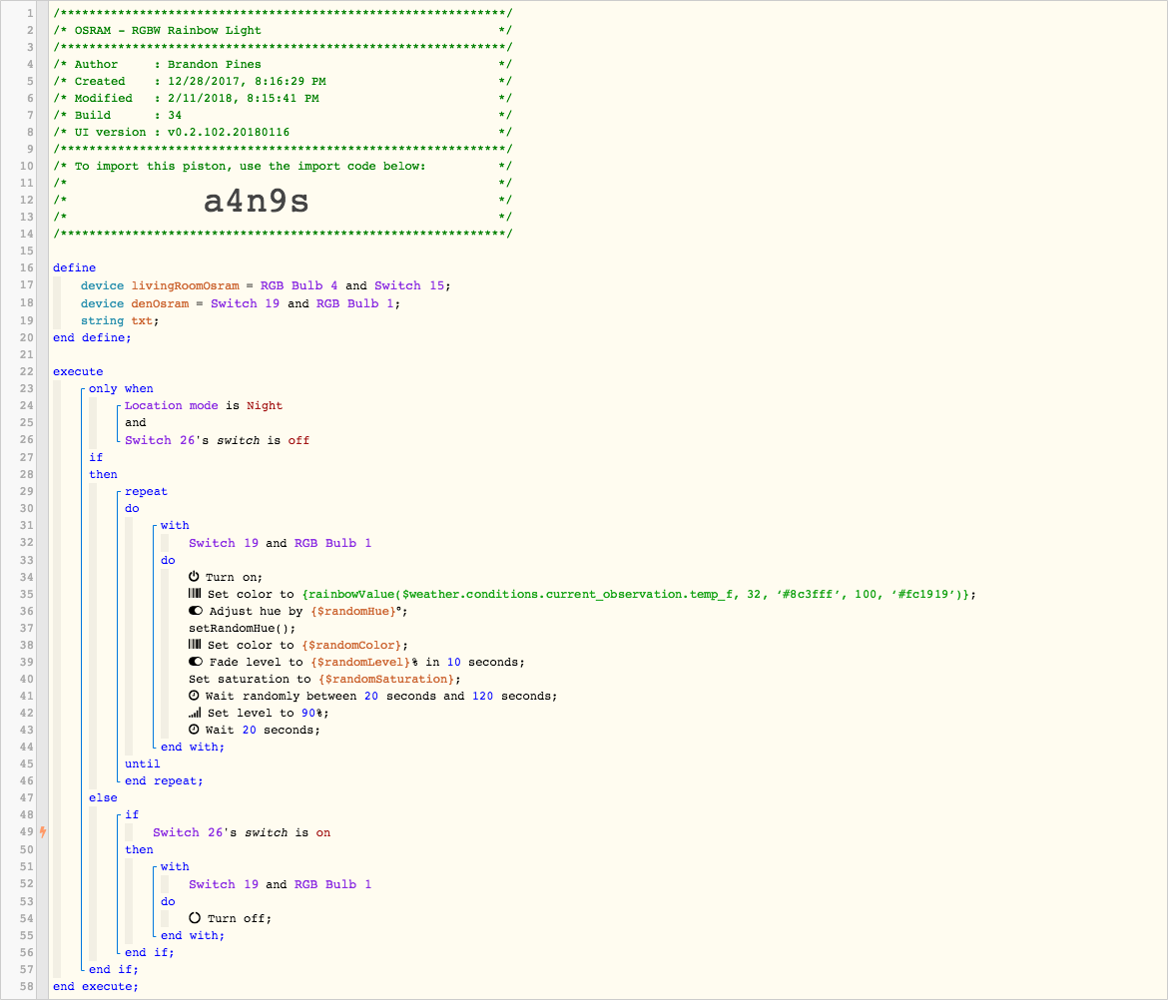

The first half of your piston has two restrictions but nothing in the ‘IF’ statement so it has no triggers.
Would it make more sense for me to move the if switch is off from the top restriction into the if statement? Additionally on the else statement I do have a trigger but that one is not working at all. Is that because I don’t have the initial if trigger on the top part of my piston?
Correct… the else won’t apply until an initial condition is set to achieve the else.
Or to state it another way, the piston as currently written will ONLY work if the switch is off. If the switch is on, it never even checks the conditions of the If-Then-Else statements. It sees line 26 is false so it stops right there.

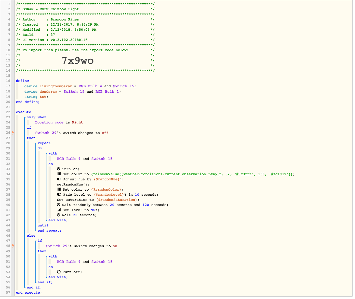

So the reason I removed the trigger from the IF was because in this version (below) when I turn off the light (the else statement) the RGBW light does not turn off.
You need to turn on switch 29 to trigger the else (not off)
Line 48 says if switch 29 switches changes to on.
I get that, but you have a trigger inside a trigger which will always cause issues.
IF switch changes to Off (trigger 1)
THEN
ELSE
IF switch changes to On (trigger 2)
Both triggers cannot occur at the exact same time so the last part of your piston cannot fire.
Try:
IF switch 29 IS on
THEN
ELSE

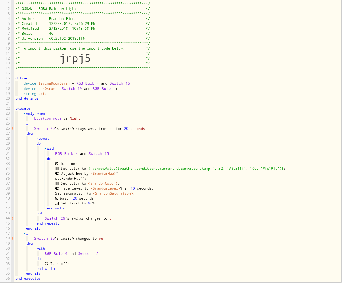

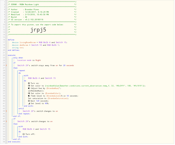

I was finally able to get it to work. I needed to use the stays for x amount of time for the RGBW light to turn off when theswtich turns on.
