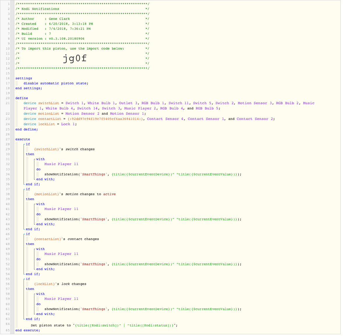

Routine or SHM Lists?
I’ve got this piston I’m using for Kodi notifications but want add to it. I’ve got device lists set as variables for all my devices and wondering if I can do the same thing for all my routines. I’d like to have a statement that says “if X Routine runs then send notification…”. I’m sure I could do it within the statement but with all the separate conditions and or’s I’ll end up taking up a bunch of space.
Additionally I’d like to do the same thing with SHM status and wondering if I can put them all in a variable like the device list. At least with the SHM statuses it wouldn’t be as long.
Well, I have seen pistons 300+ lines long, so you have plenty of elbow room in the piston above. One thing that I occasionally do to conserve space is put a common phrase into a variable first.
For example, if you want your notification to say, “Netflix was triggered at 3:45pm”, you could create a string variable:
{alert} = " was triggered at "$time
then in the appropriate section of your code, you could call that alert using less text like this:
show notification "Netflix"{alert}
which effectively turns 26 characters into 5 each time it is used.
I’ll let one of the experts chime in for list building
Hey that’s a great idea! Getting more comfortable with variables now and never even thought of doing stuff like that. Thanks!
