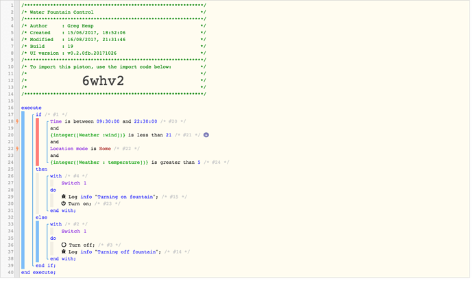

I have the below piston that controls my waterfall. It pretty much works as expected, however I’d like this to run every hour. At the moment, it only runs once in the morning at 9:30, and then in the evening at 22:30.
I’d like this to run hourly, so that if the wind changes during the day or the temperature increases, the waterfall will come on
You can insert a hourly timer and then drag the whole IF inside it.
