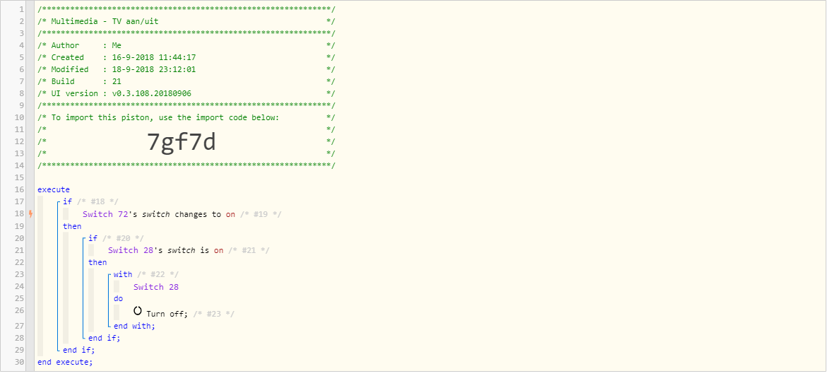

One button to turn the tv on or off depending on state.
What does work is the ‘Turn off’ and ‘turn on’ commands.
I can make a piston to just turn the tv on when i press a virtual button and it works. Aslong i dont try to use the state of the tv on/off switch in an ‘if’ block. The switch of the tv shows on and off correctly in the smartthings IDE, but in webcore its not working correct as a trigger somehow.
If instead of power on/off i use the toggle command the tv will turn off but will not turn back on by toggling.
Switch 28 = Samsung Q8 series 2018.
