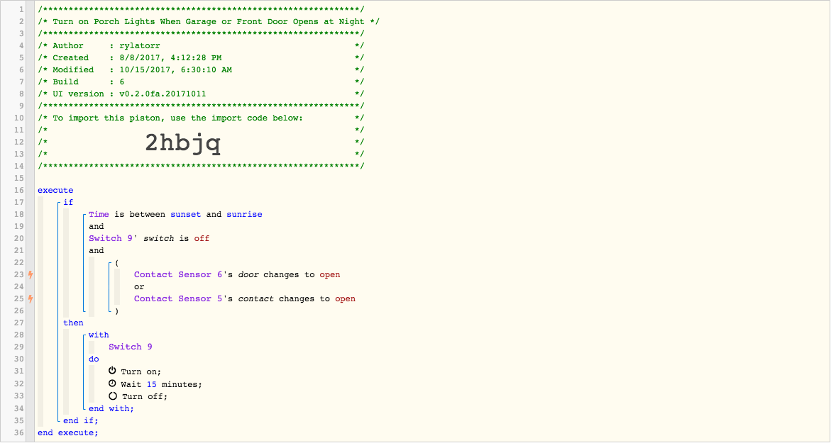

This should be a very simple piston. Turns on the porch lights when the door opens. Want them to turn off 15 mins later. But they stay on.
When door opens, turn on lights. Wait 15 mins, turn off.
The lights turn on as expected. Logs show a job scheduled for 15 mins later. The lights stay on.

In the WITH, click the cog (wheel icon) and change cancellation policy to Never Cancel. The closing event of the door is/was canceling the timer.
Ah, I was wondering if the closed action had an impact. I’ve made the change and will also read up on task cancellation policies. Thanks!
https://wiki.webcore.co/Task_Cancellation_Policy
