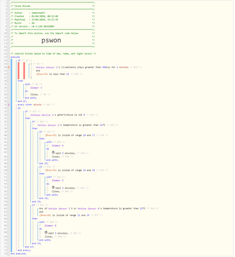

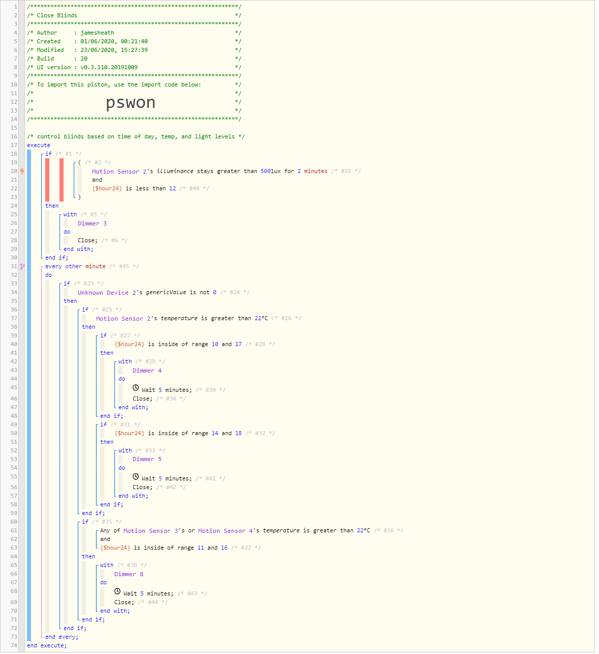

Newb here…
I have two concurrent if statements under another if.
When the top level if (#26) is true, the first of the lower level gets evaluated (#28), but the second one does not (#32).
This is clearly going to be my fault, but I can’t work out what’s wrong!
whenever #28 is evaluated, #32 is evaluated after
only #28 is being evaluated,

23/06/2020, 15:31:39 +109ms
+1ms ╔Received event [Home].time = 1592922700309 with a delay of -1201ms
+165ms ║RunTime Analysis CS > 57ms > PS > 59ms > PE > 49ms > CE
+168ms ║Runtime (44162 bytes) successfully initialized in 59ms (v0.3.110.20191009) (166ms)
+196ms ║║Comparison (string) 530 is_not (integer) 0 = true (1ms)
+198ms ║║Condition #24 evaluated true (9ms)
+199ms ║║Condition group #23 evaluated true (state did not change) (11ms)
+209ms ║║Comparison (decimal) 24.3 is_greater_than (integer) 22 = true (2ms)
+211ms ║║Condition #26 evaluated true (8ms)
+212ms ║║Condition group #25 evaluated true (state did not change) (11ms)
+221ms ║║Comparison (integer) 15 is_inside_of_range (integer) 10 .. (integer) 17 = true (2ms)
+223ms ║║Condition #28 evaluated true (7ms)
+224ms ║║Condition group #27 evaluated true (state did not change) (10ms)
+227ms ║║Cancelling statement #29's schedules...
+232ms ║║Executed virtual command [Belvedere Front Blind].wait (1ms)
+234ms ║║Requesting a wake up for Tue, Jun 23 2020 @ 3:36:39 PM BST (in 300.0s)
+241ms ║╚Execution stage complete. (72ms)
+243ms ║Setting up scheduled job for Tue, Jun 23 2020 @ 3:33:40 PM BST (in 120.958s), with 1 more job pending
+253ms ╚Event processed successfully (253ms)

23/06/2020, 15:29:39 +68ms
+0ms ╔Received event [Home].time = 1592922580309 with a delay of -1242ms
+117ms ║RunTime Analysis CS > 33ms > PS > 43ms > PE > 42ms > CE
+120ms ║Runtime (44163 bytes) successfully initialized in 43ms (v0.3.110.20191009) (118ms)
+142ms ║║Comparison (string) 530 is_not (integer) 0 = true (1ms)
+143ms ║║Condition #24 evaluated true (9ms)
+144ms ║║Condition group #23 evaluated true (state did not change) (10ms)
+154ms ║║Comparison (decimal) 24.3 is_greater_than (integer) 22 = true (1ms)
+155ms ║║Condition #26 evaluated true (9ms)
+156ms ║║Condition group #25 evaluated true (state did not change) (10ms)
+164ms ║║Comparison (integer) 15 is_inside_of_range (integer) 10 .. (integer) 17 = true (1ms)
+165ms ║║Condition #28 evaluated true (7ms)
+166ms ║║Condition group #27 evaluated true (state did not change) (8ms)
+169ms ║║Cancelling statement #29's schedules...
+174ms ║║Executed virtual command [Belvedere Front Blind].wait (1ms)
+176ms ║║Requesting a wake up for Tue, Jun 23 2020 @ 3:34:39 PM BST (in 300.0s)
+182ms ║╚Execution stage complete. (62ms)
+184ms ║Setting up scheduled job for Tue, Jun 23 2020 @ 3:30:20 PM BST (in 41.703s), with 2 more jobs pending
+196ms ╚Event processed successfully (197ms)
