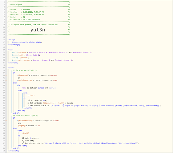

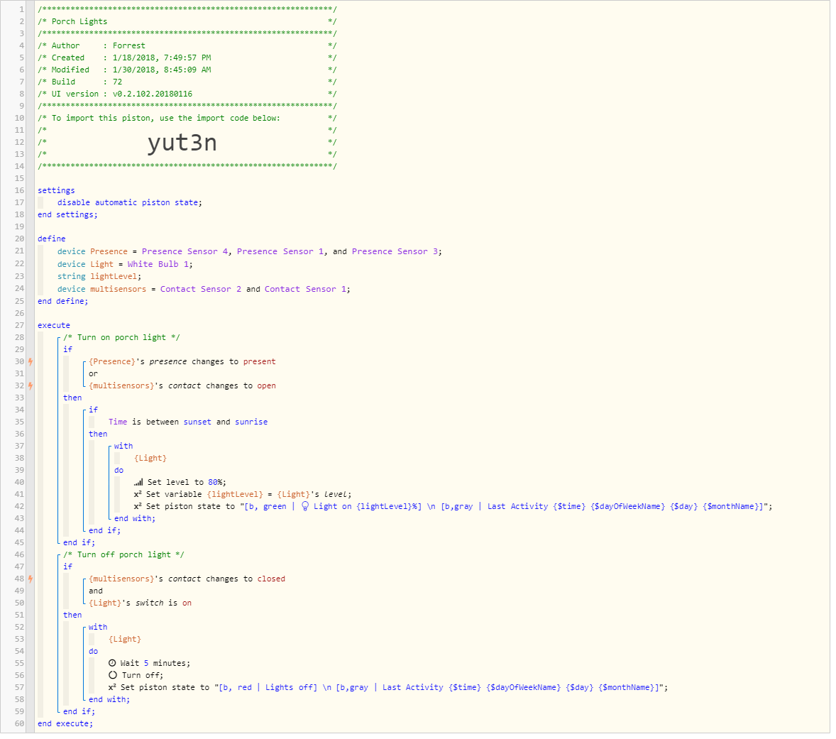

I have a piston that turns on my porch light when I come home based on presence, and turns off on a timer when either of the doors (front door, or porch door) are closed. The porch light also comes on when one of these doors is opened. Everything works as expected if I stay at home, lights comes on, turns off after 5 minutes when I close a door. Light comes on when I come home and presence changes to present etc.
This does not work when I leave my house (and presence changes to not present).
I expect the light to turn off after 5 minutes when I leave.
When I leave my house, and drive away (so change to no longer present), the light does not turn off - I assume this is because my presence is changing and somehow interrupting the timer.
5) Attach any logs
In the logs you can see the 5 minute timer being set, but when it triggers you can see the turn off aspect being skipped and not executed.
