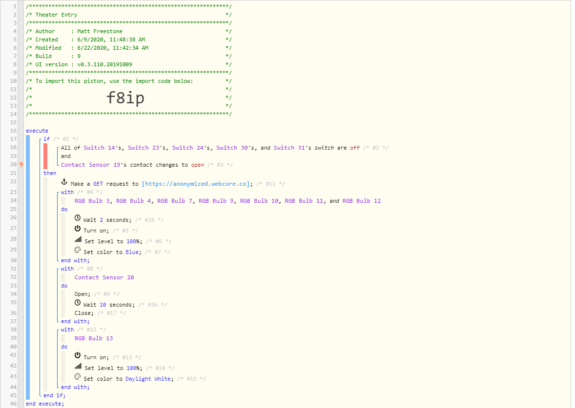

I have some pistons to turn on lights. Certain lights are going to be set to a different color than others, so I have them in different ‘with’ statements under a single ‘if’. Only the first ‘with’ executes.
Any with statement under an IF should execute.
Only the first ‘with’ statement runs.

6/22/2020, 1:33:40 PM +438ms
+1ms ╔Received event [Theater Door].contact = open with a delay of 14784ms
+121ms ║RunTime Analysis CS &gt; 29ms &gt; PS &gt; 59ms &gt; PE &gt; 33ms &gt; CE
+123ms ║Runtime (42901 bytes) successfully initialized in 59ms (v0.3.110.20191009) (121ms)
+124ms ║╔Execution stage started
+159ms ║║Comparison (enum) off is (string) off = true (1ms)
+161ms ║║Comparison (enum) off is (string) off = true (1ms)
+163ms ║║Comparison (enum) off is (string) off = true (1ms)
+165ms ║║Comparison (enum) off is (string) off = true (1ms)
+167ms ║║Comparison (enum) off is (string) off = true (1ms)
+169ms ║║Condition #2 evaluated true (41ms)
+173ms ║║Comparison (enum) open changes_to (string) open = true (1ms)
+174ms ║║Cancelling condition #3's schedules...
+175ms ║║Condition #3 evaluated true (5ms)
+176ms ║║Cancelling condition #1's schedules...
+177ms ║║Condition group #1 evaluated true (state changed) (49ms)
+179ms ║║Cancelling statement #10's schedules...
+186ms ║║Sending external web request to: 204.15.86.230:81/rest/vars/set/2/7/1
+401ms ║║Executed virtual command httpRequest (215ms)
+404ms ║║Cancelling statement #4's schedules...
+411ms ║║Executed virtual command [Island Left LED Strip, Island Right LED Strip, Theater Back Wall LED Strip, Theater Ceiling Left LED Strip, Theater Ceiling Right LED Strip, Theater Left Wall LED Strip, Theater Right Wall LED Strip].wait (1ms)
+412ms ║║Waiting for 2000ms
+2418ms ║║Skipped execution of physical command [Island Left LED Strip].on([]) because it would make no change to the device. (3ms)
+2419ms ║║Executed [Island Left LED Strip].on (5ms)
+2427ms ║║Skipped execution of physical command [Island Right LED Strip].on([]) because it would make no change to the device. (4ms)
+2428ms ║║Executed [Island Right LED Strip].on (5ms)
+2435ms ║║Skipped execution of physical command [Theater Back Wall LED Strip].on([]) because it would make no change to the device. (4ms)
+2436ms ║║Executed [Theater Back Wall LED Strip].on (6ms)
+2443ms ║║Skipped execution of physical command [Theater Ceiling Left LED Strip].on([]) because it would make no change to the device. (3ms)
+2444ms ║║Executed [Theater Ceiling Left LED Strip].on (5ms)
+2452ms ║║Skipped execution of physical command [Theater Ceiling Right LED Strip].on([]) because it would make no change to the device. (5ms)
+2453ms ║║Executed [Theater Ceiling Right LED Strip].on (6ms)
+2462ms ║║Skipped execution of physical command [Theater Left Wall LED Strip].on([]) because it would make no change to the device. (6ms)
+2463ms ║║Executed [Theater Left Wall LED Strip].on (8ms)
+2469ms ║║Skipped execution of physical command [Theater Right Wall LED Strip].on([]) because it would make no change to the device. (2ms)
+2470ms ║║Executed [Theater Right Wall LED Strip].on (4ms)
+2487ms ║║Executed physical command [Island Left LED Strip].setLevel([100]) (14ms)
+2488ms ║║Executed [Island Left LED Strip].setLevel (15ms)
+2494ms ║║Skipped execution of physical command [Island Right LED Strip].setLevel([100]) because it would make no change to the device. (5ms)
+2495ms ║║Executed [Island Right LED Strip].setLevel (6ms)
+2502ms ║║Skipped execution of physical command [Theater Back Wall LED Strip].setLevel([100]) because it would make no change to the device. (6ms)
+2503ms ║║Executed [Theater Back Wall LED Strip].setLevel (7ms)
+2510ms ║║Skipped execution of physical command [Theater Ceiling Left LED Strip].setLevel([100]) because it would make no change to the device. (5ms)
+2510ms ║║Executed [Theater Ceiling Left LED Strip].setLevel (6ms)
+2517ms ║║Skipped execution of physical command [Theater Ceiling Right LED Strip].setLevel([100]) because it would make no change to the device. (5ms)
+2518ms ║║Executed [Theater Ceiling Right LED Strip].setLevel (7ms)
+2532ms ║║Skipped execution of physical command [Theater Left Wall LED Strip].setLevel([100]) because it would make no change to the device. (12ms)
+2533ms ║║Executed [Theater Left Wall LED Strip].setLevel (13ms)
+2540ms ║║Skipped execution of physical command [Theater Right Wall LED Strip].setLevel([100]) because it would make no change to the device. (5ms)
+2541ms ║║Executed [Theater Right Wall LED Strip].setLevel (7ms)
+2551ms ║║Executed physical command [Island Left LED Strip].setColor([[hex: #0000FF, hue:67, saturation:100, level:50]]) (8ms)
+2552ms ║║Executed [Island Left LED Strip].setColor (10ms)
+2564ms ║║Executed physical command [Island Right LED Strip].setColor([[hex: #0000FF, hue:67, saturation:100, level:50]]) (10ms)
+2565ms ║║Executed [Island Right LED Strip].setColor (12ms)
+2579ms ║║Executed physical command [Theater Back Wall LED Strip].setColor([[hex: #0000FF, hue:67, saturation:100, level:50]]) (11ms)
+2580ms ║║Executed [Theater Back Wall LED Strip].setColor (14ms)
+2594ms ║║Executed physical command [Theater Ceiling Left LED Strip].setColor([[hex: #0000FF, hue:67, saturation:100, level:50]]) (11ms)
+2595ms ║║Executed [Theater Ceiling Left LED Strip].setColor (13ms)
+2607ms ║║Executed physical command [Theater Ceiling Right LED Strip].setColor([[hex: #0000FF, hue:67, saturation:100, level:50]]) (11ms)
+2608ms ║║Executed [Theater Ceiling Right LED Strip].setColor (13ms)
+2621ms ║║Executed physical command [Theater Left Wall LED Strip].setColor([[hex: #0000FF, hue:67, saturation:100, level:50]]) (11ms)
+2622ms ║║Executed [Theater Left Wall LED Strip].setColor (13ms)
+2635ms ║║Executed physical command [Theater Right Wall LED Strip].setColor([[hex: #0000FF, hue:67, saturation:100, level:50]]) (11ms)
+2636ms ║║Executed [Theater Right Wall LED Strip].setColor (13ms)
+2638ms ║║Cancelling statement #8's schedules...
+2686ms ║║Executed physical command [null].open() (44ms)
+2687ms ║║Executed [Theater Entry Trigger].open (46ms)
+2690ms ║║Executed virtual command [Theater Entry Trigger].wait (0ms)
+2692ms ║║Requesting a wake up for Mon, Jun 22 2020 @ 1:33:53 PM MDT (in 10.0s)
+2696ms ║╚Execution stage complete. (2571ms)
+2697ms ║Setting up scheduled job for Mon, Jun 22 2020 @ 1:33:53 PM MDT (in 9.996s)
+2709ms ╚Event processed successfully (2709ms)

+3321ms ║║Executed [Island Right LED Strip].setColor (11ms)
+3332ms ║║Executed physical command [Theater Back Wall LED Strip].setColor([[hex: #0000FF, hue:67, saturation:100, level:50]]) (10ms)
+3333ms ║║Executed [Theater Back Wall LED Strip].setColor (12ms)
+3345ms ║║Executed physical command [Theater Ceiling Left LED Strip].setColor([[hex: #0000FF, hue:67, saturation:100, level:50]]) (10ms)
+3346ms ║║Executed [Theater Ceiling Left LED Strip].setColor (12ms)
+3357ms ║║Executed physical command [Theater Ceiling Right LED Strip].setColor([[hex: #0000FF, hue:67, saturation:100, level:50]]) (9ms)
+3358ms ║║Executed [Theater Ceiling Right LED Strip].setColor (11ms)
+3370ms ║║Executed physical command [Theater Left Wall LED Strip].setColor([[hex: #0000FF, hue:67, saturation:100, level:50]]) (10ms)
+3371ms ║║Executed [Theater Left Wall LED Strip].setColor (12ms)
+3383ms ║║Executed physical command [Theater Right Wall LED Strip].setColor([[hex: #0000FF, hue:67, saturation:100, level:50]]) (10ms)
+3384ms ║║Executed [Theater Right Wall LED Strip].setColor (12ms)
+3387ms ║║Cancelling statement #8's schedules...
+3434ms ║║Executed physical command [null].open() (43ms)
+3434ms ║║Executed [Theater Entry Trigger].open (45ms)
+3438ms ║║Executed virtual command [Theater Entry Trigger].wait (0ms)
+3439ms ║║Requesting a wake up for Mon, Jun 22 2020 @ 1:33:49 PM MDT (in 10.0s)
+3443ms ║╚Execution stage complete. (3325ms)
+3445ms ║Setting up scheduled job for Mon, Jun 22 2020 @ 1:33:49 PM MDT (in 9.996s)
+3454ms ╚Event processed successfully (3454ms)

+2ms ╔Received event [Theater Door].contact = open with a delay of 199ms
+9393ms ║RunTime Analysis CS &gt; 29ms &gt; PS &gt; 9323ms &gt; PE &gt; 41ms &gt; CE
+9394ms ║Piston waited at a semaphore for 9270ms
+9396ms ║Runtime (42973 bytes) successfully initialized in 9323ms (v0.3.110.20191009) (9393ms)
+9397ms ║╔Execution stage started
+9432ms ║║Comparison (enum) off is (string) off = true (2ms)
+9434ms ║║Comparison (enum) off is (string) off = true (1ms)
+9436ms ║║Comparison (enum) off is (string) off = true (1ms)
+9438ms ║║Comparison (enum) off is (string) off = true (1ms)
+9440ms ║║Comparison (enum) off is (string) off = true (1ms)
+9442ms ║║Condition #2 evaluated true (41ms)
+9445ms ║║Comparison (enum) open changes_to (string) open = true (0ms)
+9447ms ║║Cancelling condition #3's schedules...
+9448ms ║║Condition #3 evaluated true (4ms)
+9449ms ║║Cancelling condition #1's schedules...
+9449ms ║║Condition group #1 evaluated true (state changed) (48ms)
+9451ms ║║Cancelling statement #10's schedules...
+9458ms ║║Sending external web request to: 204.15.86.230:81/rest/vars/set/2/7/1
+9667ms ║║Executed virtual command httpRequest (209ms)
+9669ms ║║Cancelling statement #4's schedules...
+9678ms ║║Executed virtual command [Island Left LED Strip, Island Right LED Strip, Theater Back Wall LED Strip, Theater Ceiling Left LED Strip, Theater Ceiling Right LED Strip, Theater Left Wall LED Strip, Theater Right Wall LED Strip].wait (1ms)
+9687ms ║║Requesting a wake up for Mon, Jun 22 2020 @ 1:33:37 PM MDT (in 2.0s)
+9695ms ║╚Execution stage complete. (298ms)
+9697ms ║Setting up scheduled job for Mon, Jun 22 2020 @ 1:33:37 PM MDT (in 1.996s)
+9752ms ╚Event processed successfully (9752ms)

+1ms ╔Received event [Theater Door].contact = open with a delay of 6908ms
+115ms ║RunTime Analysis CS &gt; 29ms &gt; PS &gt; 47ms &gt; PE &gt; 39ms &gt; CE
+118ms ║Runtime (42900 bytes) successfully initialized in 47ms (v0.3.110.20191009) (116ms)
+149ms ║║Comparison (enum) off is (string) off = true (1ms)
+151ms ║║Comparison (enum) off is (string) off = true (1ms)
+154ms ║║Comparison (enum) off is (string) off = true (1ms)
+156ms ║║Comparison (enum) off is (string) off = true (2ms)
+158ms ║║Comparison (enum) off is (string) off = true (1ms)
+160ms ║║Condition #2 evaluated true (37ms)
+164ms ║║Comparison (enum) open changes_to (string) open = true (0ms)
+165ms ║║Cancelling condition #3's schedules...
+166ms ║║Condition #3 evaluated true (5ms)
+167ms ║║Cancelling condition #1's schedules...
+168ms ║║Condition group #1 evaluated true (state changed) (46ms)
+170ms ║║Cancelling statement #10's schedules...
+177ms ║║Sending external web request to: 204.15.86.230:81/rest/vars/set/2/7/1
+390ms ║║Executed virtual command httpRequest (214ms)
+392ms ║║Cancelling statement #4's schedules...
+399ms ║║Executed virtual command [Island Left LED Strip, Island Right LED Strip, Theater Back Wall LED Strip, Theater Ceiling Left LED Strip, Theater Ceiling Right LED Strip, Theater Left Wall LED Strip, Theater Right Wall LED Strip].wait (1ms)
+400ms ║║Waiting for 2000ms
+2405ms ║║Skipped execution of physical command [Island Left LED Strip].on([]) because it would make no change to the device. (2ms)
+2406ms ║║Executed [Island Left LED Strip].on (4ms)
+2412ms ║║Skipped execution of physical command [Island Right LED Strip].on([]) because it would make no change to the device. (3ms)
+2413ms ║║Executed [Island Right LED Strip].on (4ms)
+2420ms ║║Skipped execution of physical command [Theater Back Wall LED Strip].on([]) because it would make no change to the device. (4ms)
+2421ms ║║Executed [Theater Back Wall LED Strip].on (6ms)
+2427ms ║║Skipped execution of physical command [Theater Ceiling Left LED Strip].on([]) because it would make no change to the device. (2ms)
+2428ms ║║Executed [Theater Ceiling Left LED Strip].on (4ms)
+2434ms ║║Skipped execution of physical command [Theater Ceiling Right LED Strip].on([]) because it would make no change to the device. (3ms)
+2435ms ║║Executed [Theater Ceiling Right LED Strip].on (4ms)
+2443ms ║║Skipped execution of physical command [Theater Left Wall LED Strip].on([]) because it would make no change to the device. (5ms)
+2444ms ║║Executed [Theater Left Wall LED Strip].on (7ms)
+2449ms ║║Skipped execution of physical command [Theater Right Wall LED Strip].on([]) because it would make no change to the device. (2ms)
+2450ms ║║Executed [Theater Right Wall LED Strip].on (3ms)
+2465ms ║║Executed physical command [Island Left LED Strip].setLevel([100]) (11ms)
+2466ms ║║Executed [Island Left LED Strip].setLevel (12ms)
+2477ms ║║Executed physical command [Island Right LED Strip].setLevel([100]) (10ms)
+2478ms ║║Executed [Island Right LED Strip].setLevel (12ms)
+2484ms ║║Skipped execution of physical command [Theater Back Wall LED Strip].setLevel([100]) because it would make no change to the device. (4ms)
+2484ms ║║Executed [Theater Back Wall LED Strip].setLevel (5ms)
+2490ms ║║Skipped execution of physical command [Theater Ceiling Left LED Strip].setLevel([100]) because it would make no change to the device. (4ms)
+2491ms ║║Executed [Theater Ceiling Left LED Strip].setLevel (5ms)
+2498ms ║║Skipped execution of physical command [Theater Ceiling Right LED Strip].setLevel([100]) because it would make no change to the device. (6ms)
+2499ms ║║Executed [Theater Ceiling Right LED Strip].setLevel (8ms)
+2511ms ║║Skipped execution of physical command [Theater Left Wall LED Strip].setLevel([100]) because it would make no change to the device. (11ms)
+2512ms ║║Executed [Theater Left Wall LED Strip].setLevel (12ms)
+2517ms ║║Skipped execution of physical command [Theater Right Wall LED Strip].setLevel([100]) because it would make no change to the device. (4ms)
+2518ms ║║Executed [Theater Right Wall LED Strip].setLevel (5ms)
+2527ms ║║Executed physical command [Island Left LED Strip].setColor([[hex: #0000FF, hue:67, saturation:100, level:50]]) (5ms)
+2528ms ║║Executed [Island Left LED Strip].setColor (7ms)
+2535ms ║║Executed physical command [Island Right LED Strip].setColor([[hex: #0000FF, hue:67, saturation:100, level:50]]) (6ms)
+2536ms ║║Executed [Island Right LED Strip].setColor (8ms)
+2546ms ║║Executed physical command [Theater Back Wall LED Strip].setColor([[hex: #0000FF, hue:67, saturation:100, level:50]]) (9ms)
+2547ms ║║Executed [Theater Back Wall LED Strip].setColor (9ms)
+2557ms ║║Executed physical command [Theater Ceiling Left LED Strip].setColor([[hex: #0000FF, hue:67, saturation:100, level:50]]) (9ms)
+2558ms ║║Executed [Theater Ceiling Left LED Strip].setColor (11ms)
+2568ms ║║Executed physical command [Theater Ceiling Right LED Strip].setColor([[hex: #0000FF, hue:67, saturation:100, level:50]]) (9ms)
+2569ms ║║Executed [Theater Ceiling Right LED Strip].setColor (10ms)
+2580ms ║║Executed physical command [Theater Left Wall LED Strip].setColor([[hex: #0000FF, hue:67, saturation:100, level:50]]) (8ms)
+2581ms ║║Executed [Theater Left Wall LED Strip].setColor (10ms)
+2591ms ║║Executed physical command [Theater Right Wall LED Strip].setColor([[hex: #0000FF, hue:67, saturation:100, level:50]]) (9ms)
+2592ms ║║Executed [Theater Right Wall LED Strip].setColor (11ms)
+2594ms ║║Cancelling statement #8's schedules...
+2636ms ║║Executed physical command [null].open() (38ms)
+2637ms ║║Executed [Theater Entry Trigger].open (40ms)
+2640ms ║║Executed virtual command [Theater Entry Trigger].wait (0ms)
+2641ms ║║Requesting a wake up for Mon, Jun 22 2020 @ 1:33:44 PM MDT (in 10.0s)
+2645ms ║╚Execution stage complete. (2527ms)
+2647ms ║Setting up scheduled job for Mon, Jun 22 2020 @ 1:33:44 PM MDT (in 9.996s)
+2658ms ╚Event processed successfully (2658ms)

+2ms ╔Received event [Theater Door].contact = open with a delay of 3514ms
+202ms ║RunTime Analysis CS &gt; 23ms &gt; PS &gt; 140ms &gt; PE &gt; 39ms &gt; CE
+205ms ║Runtime (42902 bytes) successfully initialized in 140ms (v0.3.110.20191009) (203ms)
+206ms ║╔Execution stage started
+235ms ║║Comparison (enum) off is (string) off = true (1ms)
+238ms ║║Comparison (enum) off is (string) off = true (1ms)
+240ms ║║Comparison (enum) off is (string) off = true (2ms)
+242ms ║║Comparison (enum) off is (string) off = true (1ms)
+244ms ║║Comparison (enum) off is (string) off = true (1ms)
+246ms ║║Condition #2 evaluated true (36ms)
+250ms ║║Comparison (enum) open changes_to (string) open = true (1ms)
+251ms ║║Cancelling condition #3's schedules...
+252ms ║║Condition #3 evaluated true (5ms)
+253ms ║║Cancelling condition #1's schedules...
+254ms ║║Condition group #1 evaluated true (state changed) (45ms)
+256ms ║║Cancelling statement #10's schedules...
+263ms ║║Sending external web request to: 204.15.86.230:81/rest/vars/set/2/7/1
+477ms ║║Executed virtual command httpRequest (215ms)
+480ms ║║Cancelling statement #4's schedules...
+486ms ║║Executed virtual command [Island Left LED Strip, Island Right LED Strip, Theater Back Wall LED Strip, Theater Ceiling Left LED Strip, Theater Ceiling Right LED Strip, Theater Left Wall LED Strip, Theater Right Wall LED Strip].wait (0ms)
+487ms ║║Waiting for 2000ms
+2493ms ║║Skipped execution of physical command [Island Left LED Strip].on([]) because it would make no change to the device. (2ms)
+2494ms ║║Executed [Island Left LED Strip].on (4ms)
+2499ms ║║Skipped execution of physical command [Island Right LED Strip].on([]) because it would make no change to the device. (2ms)
+2500ms ║║Executed [Island Right LED Strip].on (4ms)
+2506ms ║║Skipped execution of physical command [Theater Back Wall LED Strip].on([]) because it would make no change to the device. (3ms)
+2507ms ║║Executed [Theater Back Wall LED Strip].on (3ms)
+2512ms ║║Skipped execution of physical command [Theater Ceiling Left LED Strip].on([]) because it would make no change to the device. (1ms)
+2513ms ║║Executed [Theater Ceiling Left LED Strip].on (3ms)
+2519ms ║║Skipped execution of physical command [Theater Ceiling Right LED Strip].on([]) because it would make no change to the device. (3ms)
+2520ms ║║Executed [Theater Ceiling Right LED Strip].on (5ms)
+2529ms ║║Skipped execution of physical command [Theater Left Wall LED Strip].on([]) because it would make no change to the device. (6ms)
+2530ms ║║Executed [Theater Left Wall LED Strip].on (8ms)
+2536ms ║║Skipped execution of physical command [Theater Right Wall LED Strip].on([]) because it would make no change to the device. (3ms)
+2537ms ║║Executed [Theater Right Wall LED Strip].on (5ms)
+2551ms ║║Executed physical command [Island Left LED Strip].setLevel([100]) (11ms)
+2552ms ║║Executed [Island Left LED Strip].setLevel (13ms)
+2564ms ║║Executed physical command [Island Right LED Strip].setLevel([100]) (11ms)
+2565ms ║║Executed [Island Right LED Strip].setLevel (12ms)
+2572ms ║║Skipped execution of physical command [Theater Back Wall LED Strip].setLevel([100]) because it would make no change to the device. (6ms)
+2573ms ║║Executed [Theater Back Wall LED Strip].setLevel (7ms)
+2579ms ║║Skipped execution of physical command [Theater Ceiling Left LED Strip].setLevel([100]) because it would make no change to the device. (4ms)
+2579ms ║║Executed [Theater Ceiling Left LED Strip].setLevel (5ms)
+2586ms ║║Skipped execution of physical command [Theater Ceiling Right LED Strip].setLevel([100]) because it would make no change to the device. (5ms)
+2587ms ║║Executed [Theater Ceiling Right LED Strip].setLevel (7ms)
+2598ms ║║Skipped execution of physical command [Theater Left Wall LED Strip].setLevel([100]) because it would make no change to the device. (10ms)
+2599ms ║║Executed [Theater Left Wall LED Strip].setLevel (12ms)
+2605ms ║║Skipped execution of physical command [Theater Right Wall LED Strip].setLevel([100]) because it would make no change to the device. (5ms)
+2606ms ║║Executed [Theater Right Wall LED Strip].setLevel (6ms)
+2614ms ║║Executed physical command [Island Left LED Strip].setColor([[hex: #0000FF, hue:67, saturation:100, level:50]]) (5ms)
+2615ms ║║Executed [Island Left LED Strip].setColor (7ms)
+2622ms ║║Executed physical command [Island Right LED Strip].setColor([[hex: #0000FF, hue:67, saturation:100, level:50]]) (5ms)
+2623ms ║║Executed [Island Right LED Strip].setColor (7ms)
+2633ms ║║Executed physical command [Theater Back Wall LED Strip].setColor([[hex: #0000FF, hue:67, saturation:100, level:50]]) (8ms)
+2634ms ║║Executed [Theater Back Wall LED Strip].setColor (10ms)
+2643ms ║║Executed physical command [Theater Ceiling Left LED Strip].setColor([[hex: #0000FF, hue:67, saturation:100, level:50]]) (8ms)
+2644ms ║║Executed [Theater Ceiling Left LED Strip].setColor (9ms)
+2654ms ║║Executed physical command [Theater Ceiling Right LED Strip].setColor([[hex: #0000FF, hue:67, saturation:100, level:50]]) (8ms)
+2655ms ║║Executed [Theater Ceiling Right LED Strip].setColor (10ms)
+2664ms ║║Executed physical command [Theater Left Wall LED Strip].setColor([[hex: #0000FF, hue:67, saturation:100, level:50]]) (8ms)
+2665ms ║║Executed [Theater Left Wall LED Strip].setColor (9ms)
+2675ms ║║Executed physical command [Theater Right Wall LED Strip].setColor([[hex: #0000FF, hue:67, saturation:100, level:50]]) (8ms)
+2676ms ║║Executed [Theater Right Wall LED Strip].setColor (9ms)
+2678ms ║║Cancelling statement #8's schedules...
+2725ms ║║Executed physical command [null].open() (43ms)
+2726ms ║║Executed [Theater Entry Trigger].open (45ms)
+2729ms ║║Executed virtual command [Theater Entry Trigger].wait (1ms)
+2730ms ║║Requesting a wake up for Mon, Jun 22 2020 @ 1:33:41 PM MDT (in 10.0s)
+2734ms ║╚Execution stage complete. (2529ms)
+2735ms ║Setting up scheduled job for Mon, Jun 22 2020 @ 1:33:41 PM MDT (in 9.996s)
+2747ms ╚Event processed successfully (2746ms)

I believe you need to set Task Cancellation Policy to “Never” on some of the WITH blocks…
(start with the WITH block that contains the first WAIT, and work your way downwards)
This will force the remaining commands to continue onwards…
(even if some condition has changed)
Note: I preformatted pic your giant log so it is easier to read…

If it were me, I would focus on the sextuple triggers before worrying about this piston in particular.
(IE: you do not want 6 copies running simultaneously with TCP set to Never)

That’s an interesting one. There seems to be a lot of events for the door opening and only a couple for it closing. Normally SmartThings filters events so that only state changes get through, so even if the device reported open / open / open / open / open / close you’d only see open / close. The device handler would have to choose to override this behaviour.
Another thing is that the ‘changes to open’ trigger is evaluating as true for all the opens. The ‘changes to’ comparison is between the event in the piston and a cached previous value. So if the piston did receive close / open / open / open / open it would normally only consider the first one as a change. The fact it isn’t working like that suggests the previous value isn’t being cached until the piston reaches its end.
What I THINK is happening is …
The door starts as closed and then opens. The ‘if’ evaluates as true and the piston works its way to the ten second wait and then sets a wake up and exits (that is how waits over five seconds work). While the piston is sleeping a new open event comes along and a new instance of the piston starts up. As the piston hasn’t updated its cache the ‘if’ evaluates as true again and repeats the process. When it gets to the ten second wait the previous wake up is cancelled and a new ten second wait starts (this is called the Task Scheduling Policy). Then while that wait is happening another open event arrives and the same thing happens. So until the frequent opens stop occurring the wait is constantly being refreshed. It may be this is perfectly acceptable or indeed desirable behaviour, though I suspect it isn’t.
You might want to set the Task Cancellation Policy to ‘Never Cancel Tasks’ on the middle ‘with’ (the one with the ten second wait in it) so that when door event does eventually get closed, it doesn’t cancel the wake up from the wait and the contact closes and the remaining lights turn on. This could well be the actual problem.
I do feel that all those ‘open’ events are doing you no favours at all though.
Thanks everyone, I have resolved the issue. The issue seemed to be caused by the changing state of the virtual contact sensor. I just set that to change it to open in my existing piston, then created a new piston that said ‘if this sensor changed to open, wait 10 seconds, then set it back to closed.’ That seemed to fix everything.
