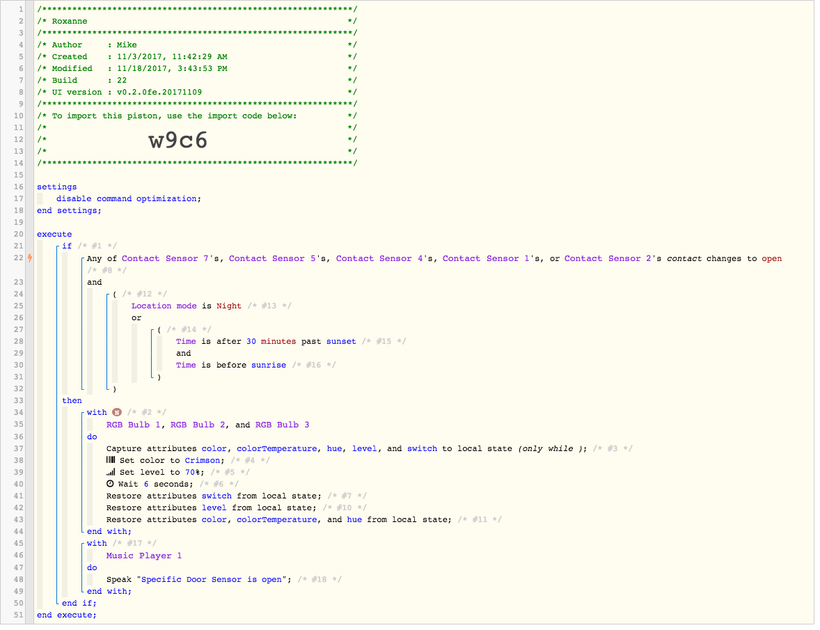

Trying to announce the open door sensor in same piston that I’m triggering light change for door sensors
DLNA speaker will announce which door has opened.
The light execution works great, but now I want voice alerts (and the fabriq DLNA Alexa speaker is amazing for those looking for an easy option). Trying to understand how to grab the sensor name as a dynamic variable. Do I need to see each door sensor as a variable before the task for my speaker to announce? I’m trying to make this code efficient instead of separate tasks for each door sensor.

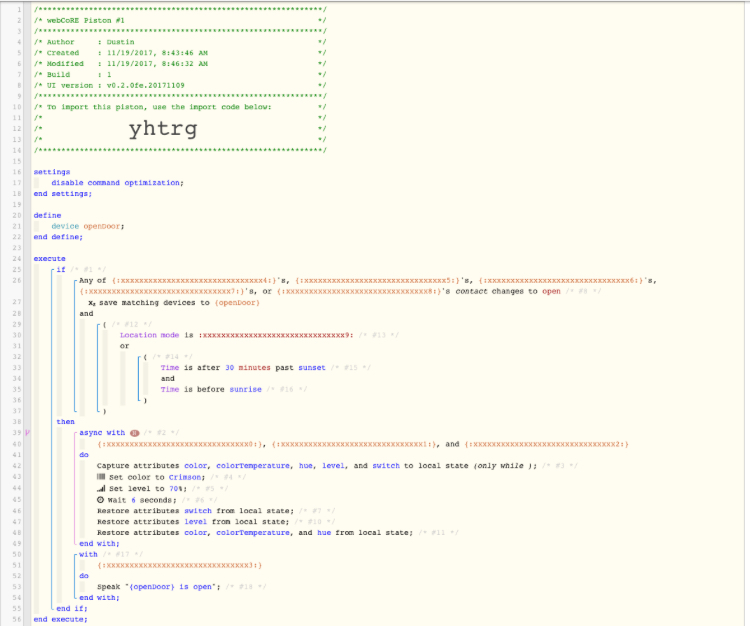

You need to create and empty device variable, then clicking on the if statement for the doors opening your open advanced options by clicking the cog. Find the option for save matching device list to variable. Select your new variable.
Further down I changed your first action with the light bulbs to asynchronous so it will execute at the same time the speaker can speak. Otherwise it will have to wait for the bulbs to do their thing until it can speak.
For the speak command I just added the variable into the text.
