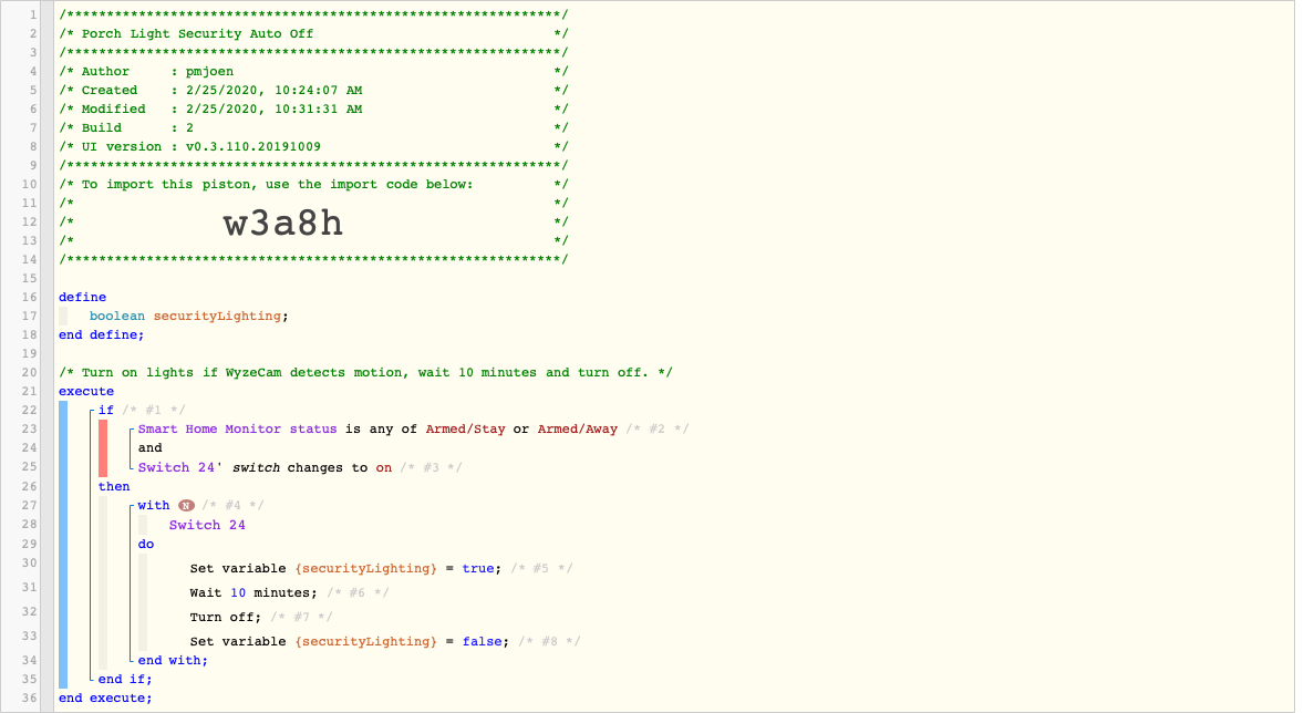

Porch Light is not turning off and variable is not being set
IFTTT sends command to turn on porch light if WyzeCam detects motion. It sets a variable, waits 10 minutes, turns off, resets variable.
I don’t see the variable being set so the light never turns off.
3/9/2020, 11:15:03 PM +991ms
+2ms ╔Received event [Porch Lights].switch = on with a delay of 142ms
+155ms ║RunTime Analysis CS > 27ms > PS > 89ms > PE > 39ms > CE
+157ms ║Runtime (39063 bytes) successfully initialized in 89ms (v0.3.110.20191009) (155ms)
+158ms ║╔Execution stage started
+167ms ║║Comparison (string) stay is_any_of (string) stay,away = true (2ms)
+168ms ║║Cancelling condition #2’s schedules…
+169ms ║║Condition #2 evaluated true (7ms)
+172ms ║║Comparison (enum) on changes_to (string) on = false (0ms)
+174ms ║║Condition #3 evaluated false (3ms)
+174ms ║║Condition group #1 evaluated false (state did not change) (12ms)
+176ms ║╚Execution stage complete. (18ms)
+177ms ╚Event processed successfully (177ms)
