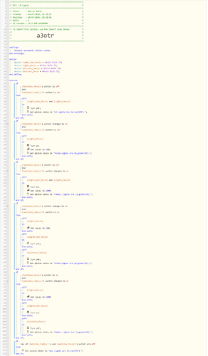

I have 8 lights in my sitting room. I have split them into 2 groups, internal 4 and the outside 4. This grouping is used to turn on and off the lights from movie mode, outside 4 dimmed to 10% and internal 4 turned off, to family lights with all 8 lights at 100%.
I’m using the attached piston to do this via ST Virtual Dimmer switches which are called via Alexa.
What I would like to do is add the ability to Dim the lights via Alexa ie Alexa Dim the Lights 50%. Whilst Alexa does as instructed and I see the Virtual Dimmer Switch dropped down 50% the lights stay the same.
Enhance the existing piston and add in the ability to Dim up or down the lights as requested.
Not much as I haven’t coded it, as I don’t know how to logically add this in. However what I do see is when I tell Alexa to Dim the lights 50% the Virtual Dimmer Switch will drop down 50% from where it was (noticed via the slider) however the lights themselves do not Dim.

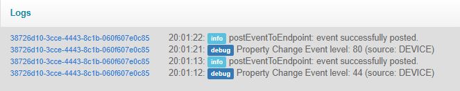

Logs from Live Logging when I move the VDS dimmer up or down.
Alexa

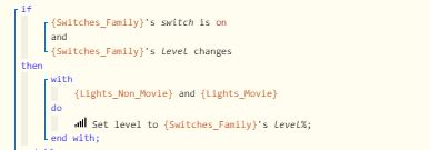

Here is the method I employ to let a Simulated Dimmer switch act like a Master Dimmer.
temp
Whenever I change the level of the Master Dim (via Alexa etc), the other lights will adjust accordingly.
EDIT :
I recently learned that you want to make sure that you have no other triggers in the piston, or it may fire at inopportune times… (In other words, the piston I have above should be in a new piston, with only the one lightning bolt in the left margin)

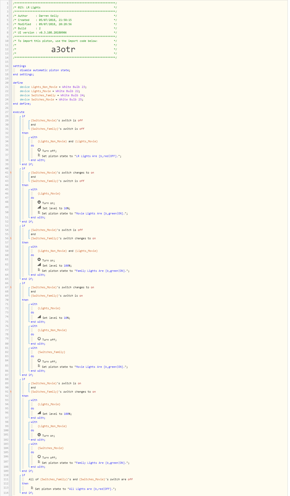

@WCMore Based on your piston i added in a new statement into my existing one and my lights are dimming based on my commands to Alexa. Your a star :slight_smile:
This is the logic I added in based on the guidance of @WCMore :slight_smile:
