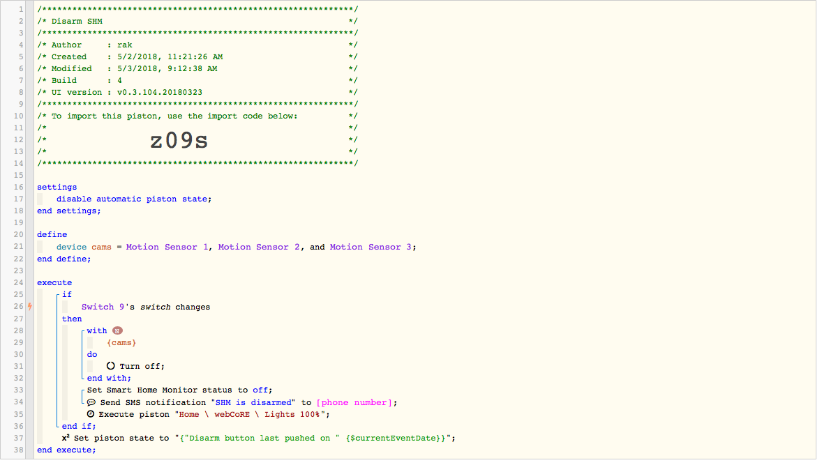

I use a virtual device for that in ST. I created a “Momentary Button Tile” virtual device in the ST IDE.
Give webcore access to to that device, then you can use it like this:
In the example above, “switch 9” is my virtual button.
