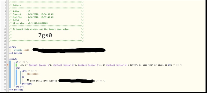

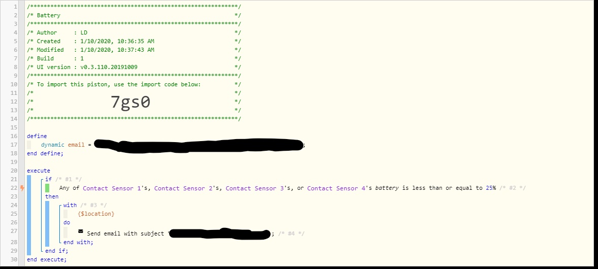

Newby here, I would like to add the actual battery percentage when I send my email for low batteries. Thanks so much for your help!
Email will contain battery percentage
No idea how to add the percentage

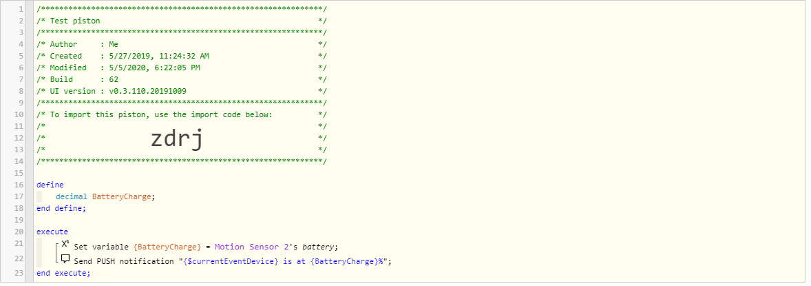

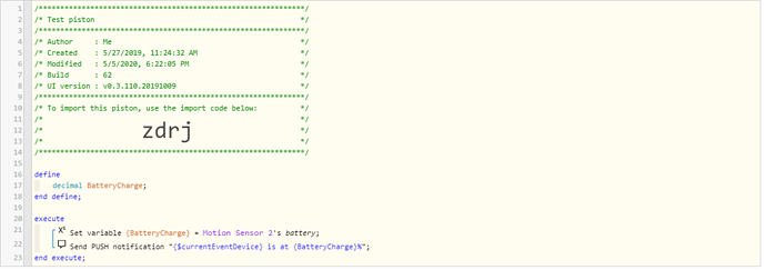

I think this would work for you. It does a push notification, just put message in email. Instead motion sensor 2 put $currentEventDevice
See if you can modify this to email you the variable in the body.

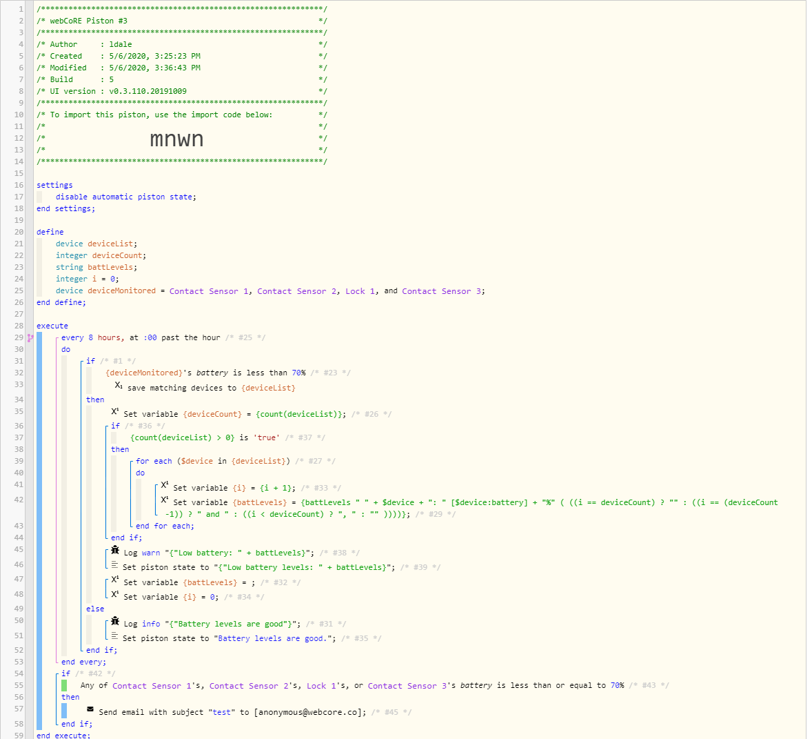

I tried this, unfortunately it doesn’t seem to want to handle more than 1 sensor at a time. So it just sends me the first one.
I am getting the device name, but nothing for battery percent. I tried battLevels as the variable, correct?

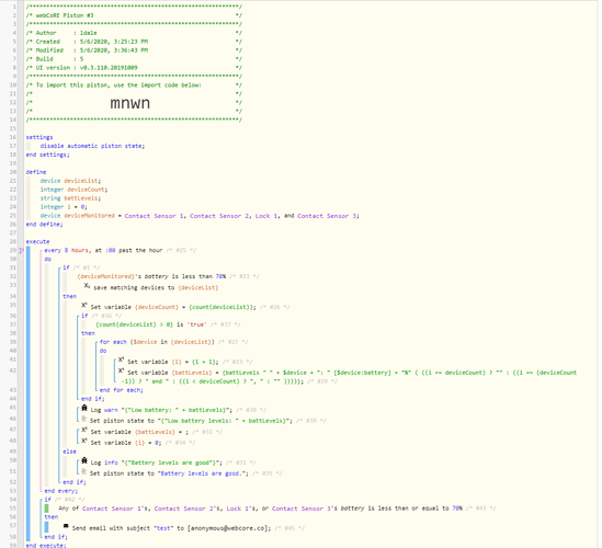

What does the piston look like?
Oops, here.

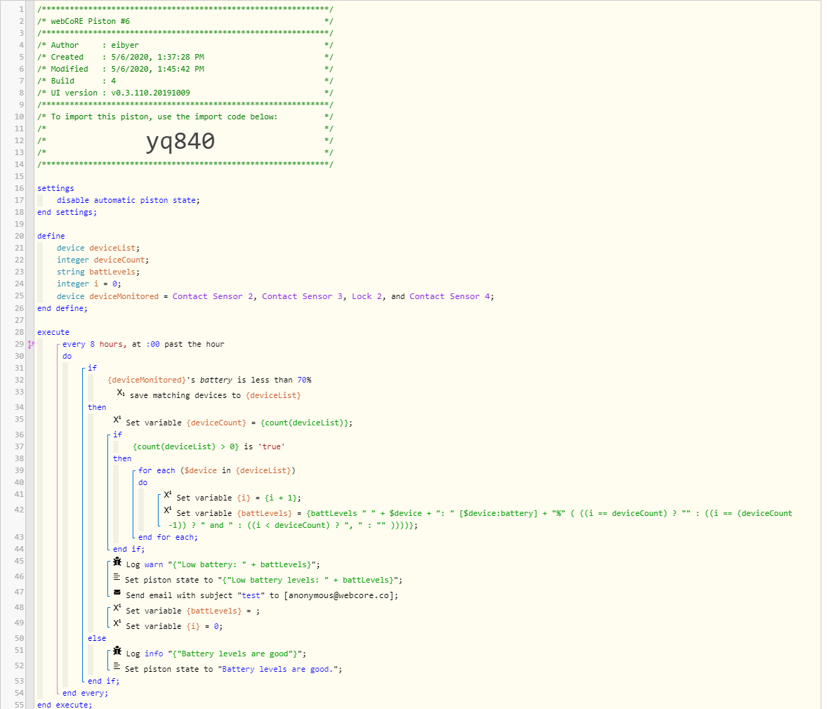

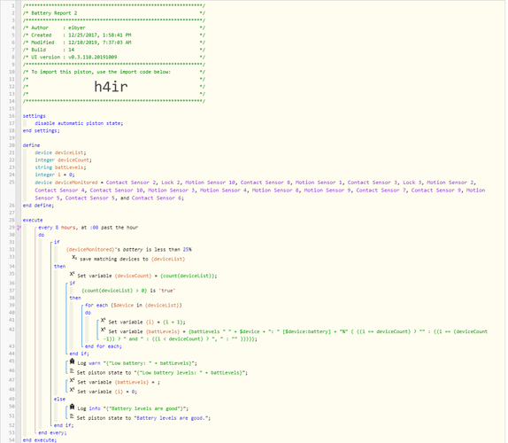

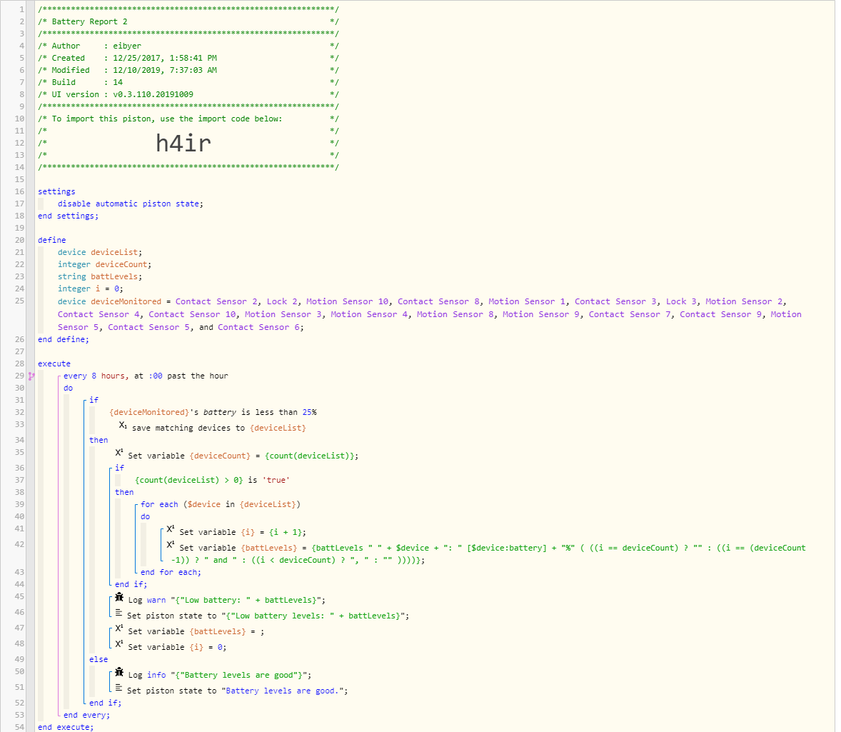

Try it in this format… you might want to adjust the time for testing.
Yep, this did it, thanks so much!!!
