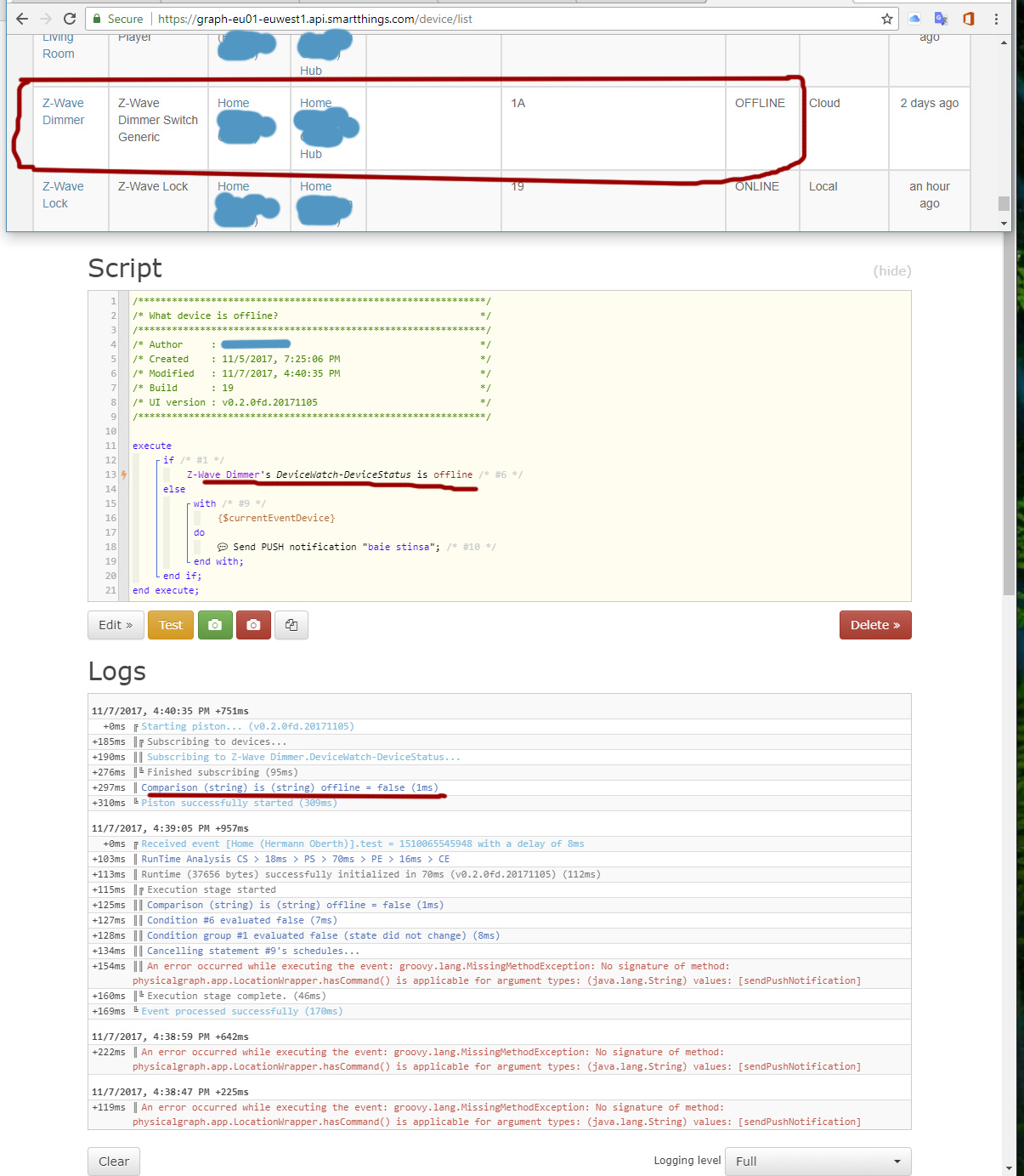

Can you help me to create a piston that show notifications with the name from all and any device that change from ONLINE from OFFLINE?

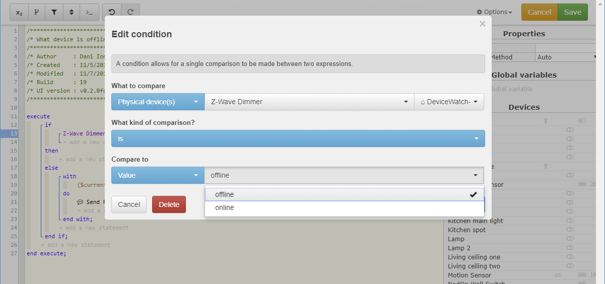

I tried this for a single device and it does not work. In spite the status is OFFLINE the pistons returns false! Why?!

It’s also case sensitive, try OFFLINE
Hey eibyer,
Unfortunatelly it is not a mistake. This status is inserted by webCoRE interface.

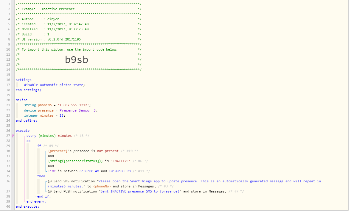

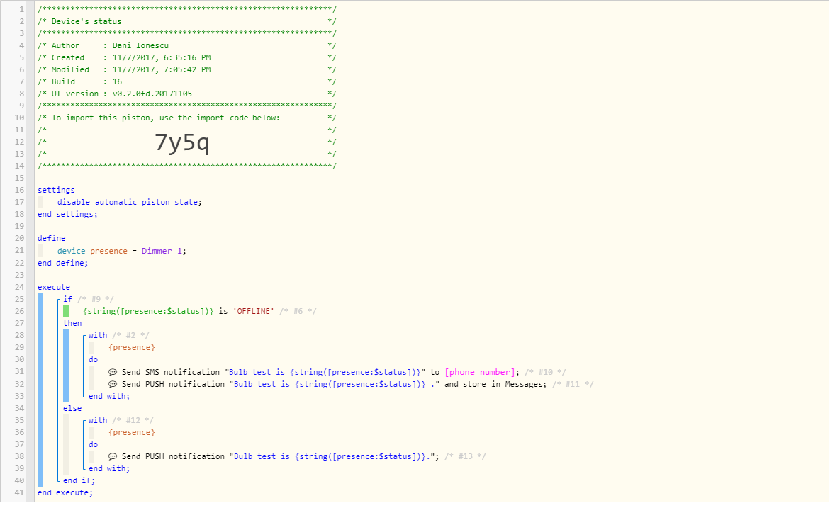

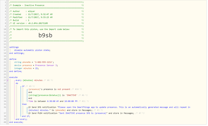

I see, I tried it before but I was using the $status system variable. See if it works for what you’re doing:
It should look something like:

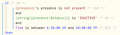

string([zwaveDimmer:$status]) is 'OFFLINE'
Could me send your piston? I don’t know how to write the code :" {presence}’ present is not present".
THX

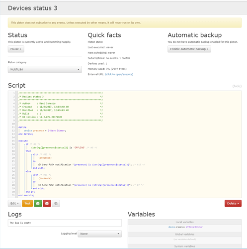

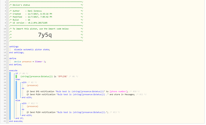

Here’s the whole thing.
Thank you, with your help I’ve made it and it works.

I don’t have address book enabled but I believe you can select multiple contacts to send to.

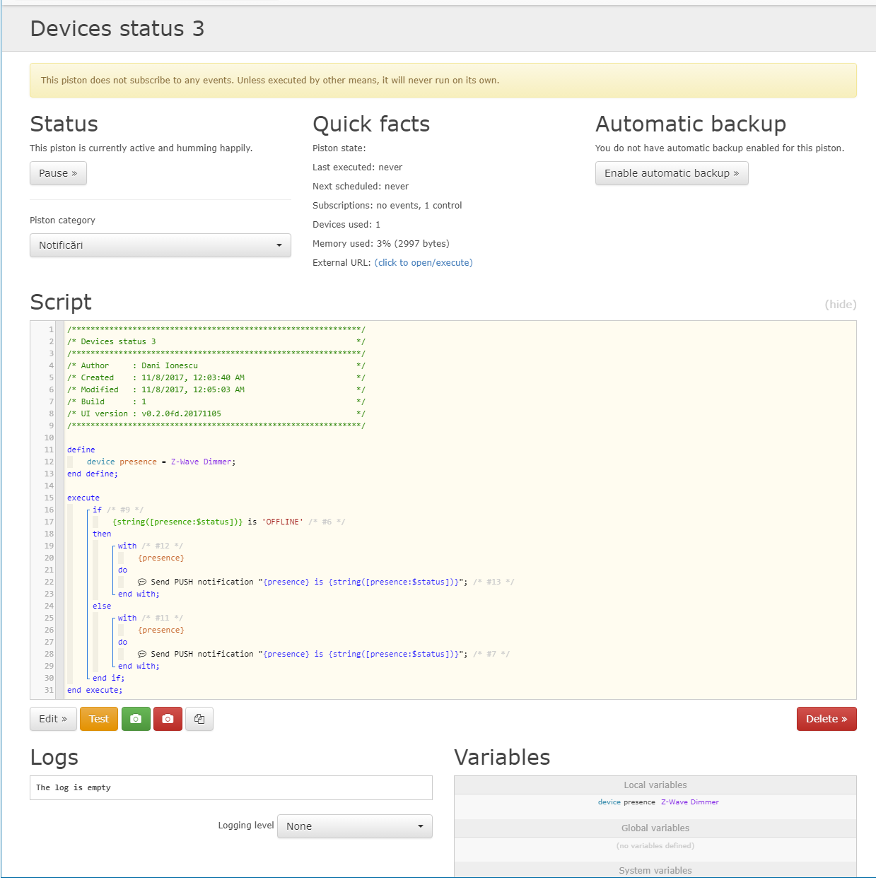

I will figure out to send it to multiple contacts. But until then, how can I make the piston to autorun itself when the event the status of devices change to OFFLINE/INACTIVE?
In this way that you showed to me, works only if I gave him “run at every xx”. But I want to run in an “IF” just like bellow. But it doesn’t run by itself :frowning:.
Unfortunately, we cannot subscribe to $status so that was my workaround at the time. If you have a noisy device (something with events every so many minutes) you can use it as the trigger in the IF.

OFFLINE events are not instantaneous. This may help to get you started:
