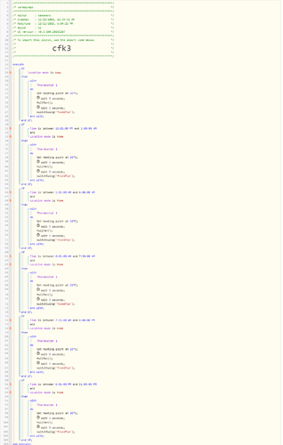

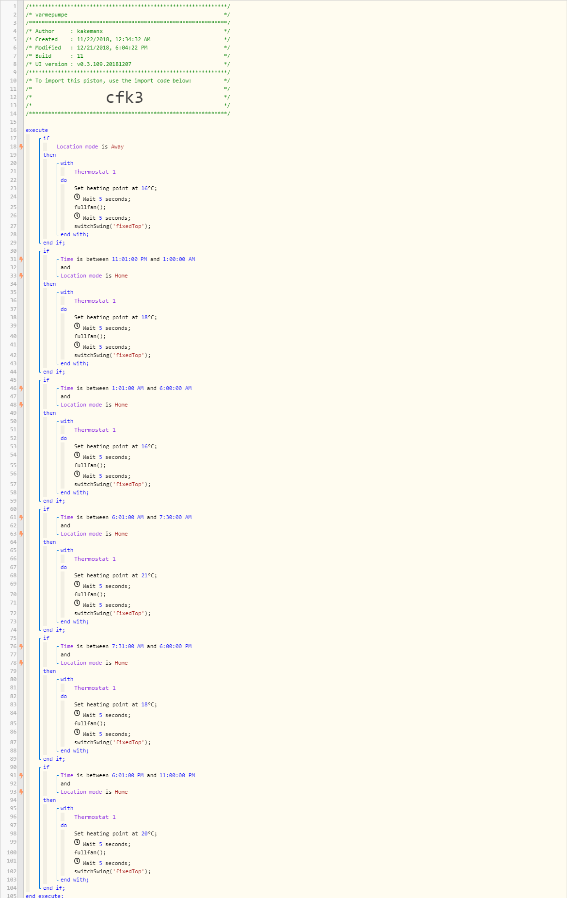

Sensibo sky and webcore gone rouge
f mode set to away, the sensibo will set correct temperature, but keeps on sending the commands for temp, fanspeed and fan swing over and over…Same if mode is home, it sets the correct temp/fan for the given timeperiodes, but keeps on looping the command :confused:
The command should run ONCE at the different times and modes
As stated point 1, command loop

You have no precise triggers in this piston, so each condition becomes a trigger.
(seen by all the lightning bolts in the left margin)
In general, I try to keep each piston limited to one or two triggers, and put conditions inside that.
For example, in your ‘Welcome Home’ piston, you could do this:
If Location mode changes to Home  <-- Trigger (precise moment in time)
    IF Time is between W and X    <-- Condition
        Then do something
    End IF
    IF Time is between X and Y    <-- Condition
        Then do something else
    End IF
    IF Time is between Y and Z    <-- Condition
        Then do different actions
    End IF
End IF
Side Note:
Make sure your times match (IE: 11PM - 1AM and then 1AM - 6AM)
otherwise there will be a single minute when the piston does nothing.
One thing though is, if you are home all day, the above will not adjust throughout the day, since you are not arriving home. If that is what you want, then a different strategy is required.
The way I usually do it is split it into two pistons. One piston focusing on what I want to happen when I first arrive home (as seen above) and one piston focusing on the time of day being the triggers, like this:
Every day at 11PM               <-- Trigger (precise moment in time)
Do
    IF Location mode is Home    <-- Condition
        Then do something
        Else do something else
    End IF
End Every
