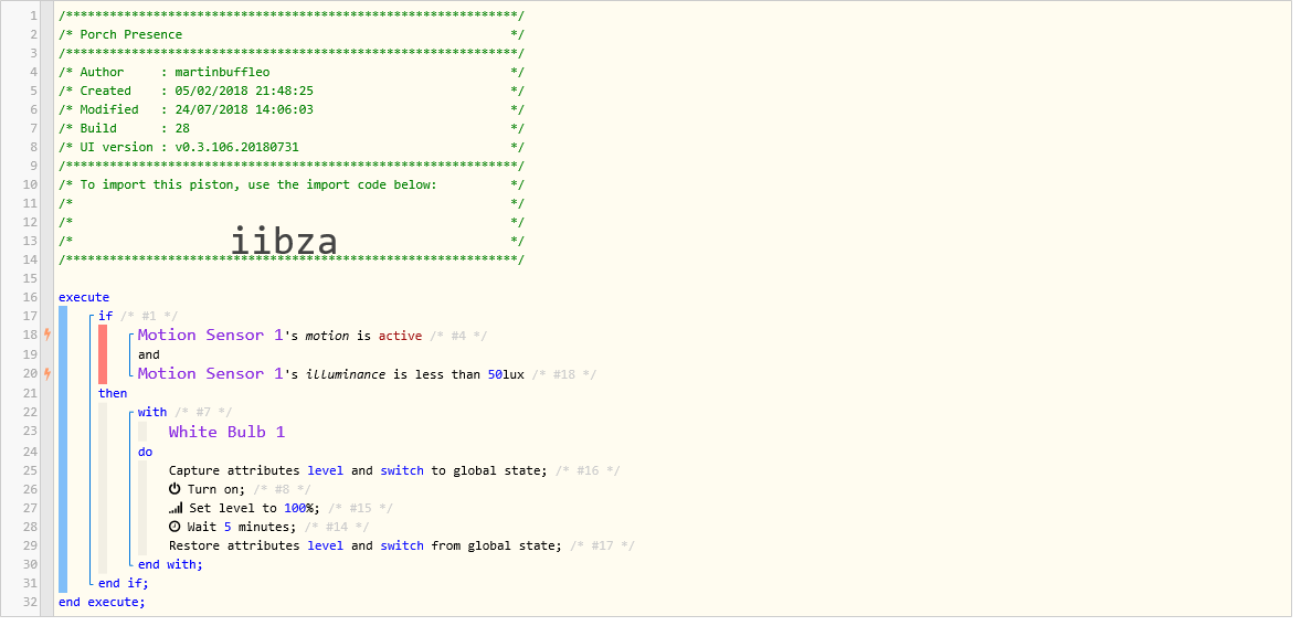

Trying to have the lights on between sunset and 22hrs at 10% then off after that.
If motion detected at any time when its dark set the light to 100% then return to original state
I think its running twice on motion which cause it to capture 100% on.

The first thing to try is setting TCP to never.
The way you have it at the moment, when motion sensor goes inactive the task will cancel at the 5 minute wait.
Also get rid of your Turn On. Just use the set level.
oh ok so the task would only run whilst the if condition was met.
Have made the changes will test tonight thanks.
If you look at TCP the default is to ‘Cancel on Condition change’ (I think).
This means when the motion sensors condition goes inactive the task will cancel.
If you set it to ‘Never’ then the tasks will never cancel and will mature. If motion is detected before the 5 minute wait matures then the tasks will start again from the top.

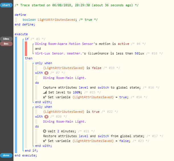

Just tested this and if there is no motion, the attributes are restored OK to the light.
If there is motion before the timer expires it saves the new attributes.

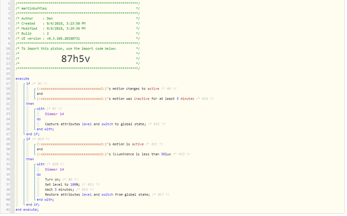

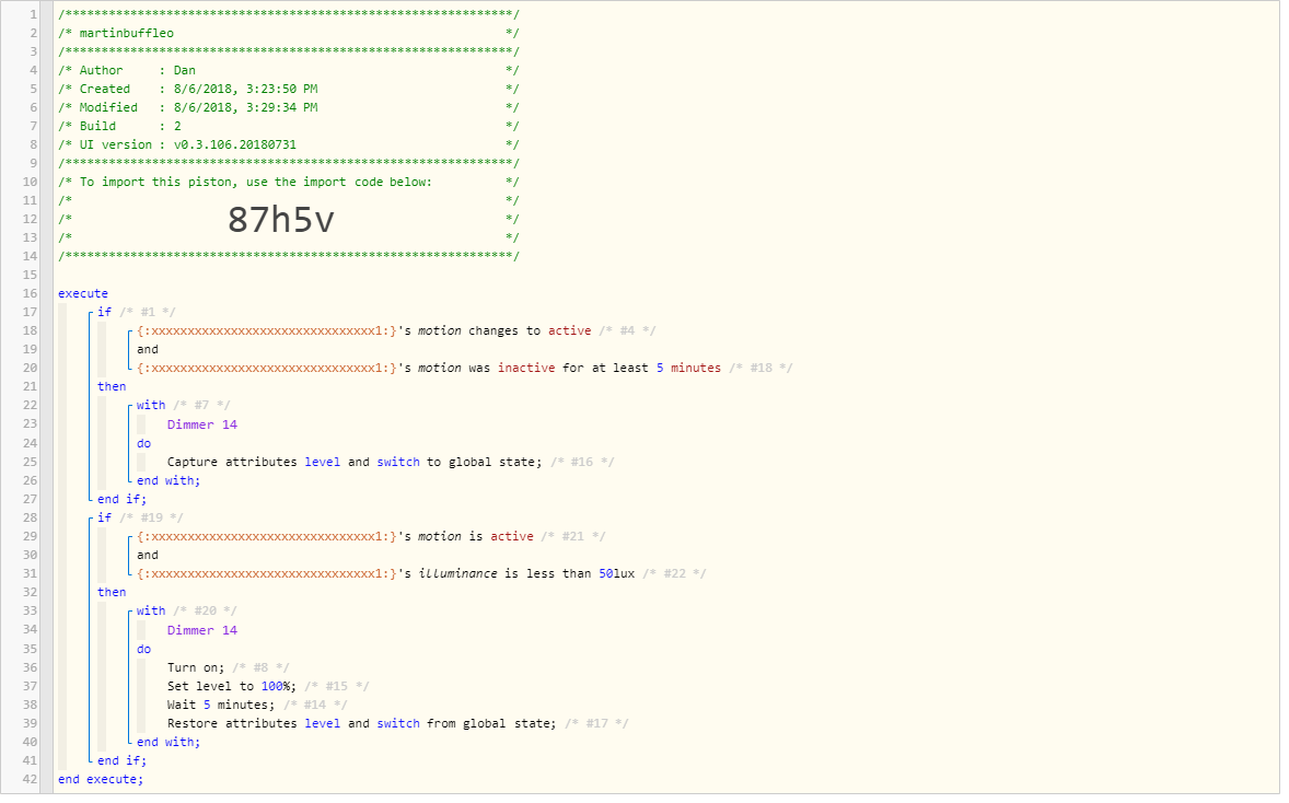

If you don’t want subsequent motions to overwrite your stored values, you need to break out the conditions separately. I haven’t put this through the paces, but logically it should do what you’re attempting to do:
