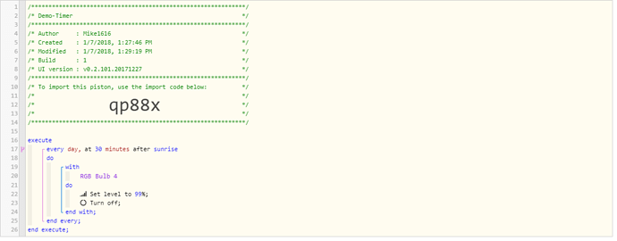

I set and reset all of mine doing exactly what you’re talking about. Post the piston that you say doesn’t work and we’ll figure it out.
As for setting the level w/o turning on the lights…none of mine work that way. They all turn on briefly as they are reset. But then I turn them off again. There’s a way to capture their “state” if you want to get fancy with it too.
You really want,
Every day at 30 minutes after $sunrise
You need to set up a Timer to do that.
