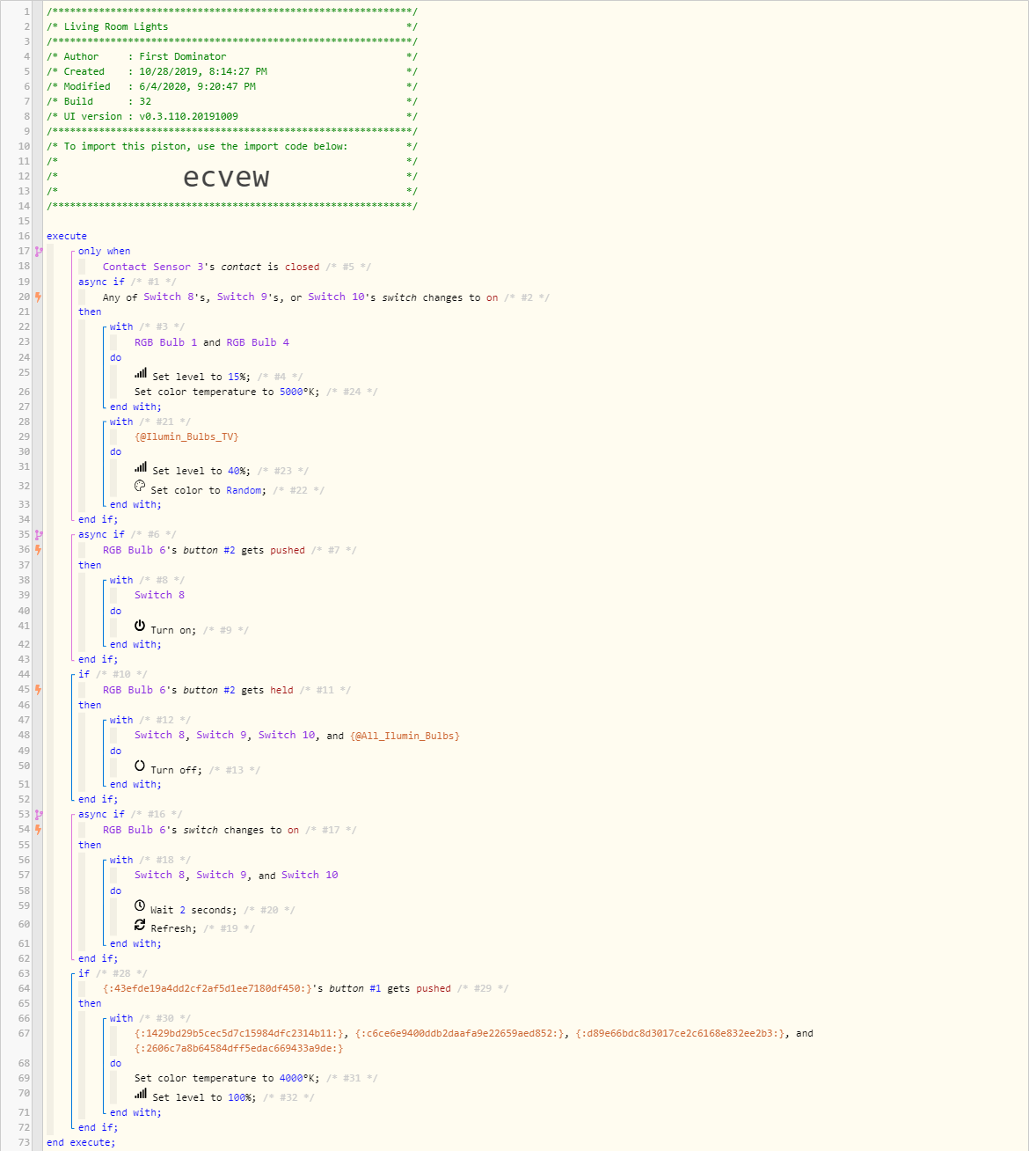

Different random colors are set to each light bulb.
Same random color for that global group.
I believe random will change every millisecond…

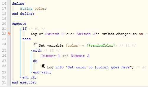

If you want both bulbs to go to the same random color, I would set a variable on the previous line. That block can be something like this:
With this method, the random color will change once each time a switch changes to on.
Also note that all of your IFs should be normal IFS… Not ASYNC.
(especially line 53!)
