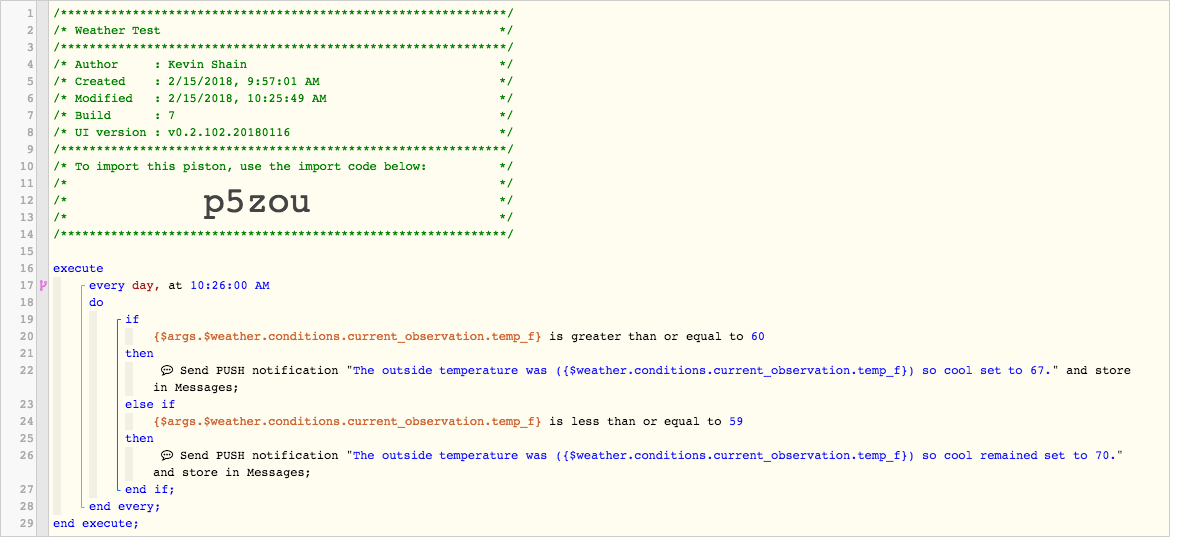

The greater than / less than statements are not working preoperly
Getting the correct push notification
I am always getting the second push notification, no matter of the data returned
**4) Post a Green Snapshot of the piston![image|45x37](
This piston is serving as a test for some statements I want to add to my thermostat piston. I thought I would start simple and see if it worked in the attached piston. What I thought should happen is that if the reported temperature is 60 or above then I should receive the first push notification. If it is 59 or below I should receive the second push notification. What is happening is that I am always getting the second notification no matter what the reported temp is (which presently is 63.6).
Without testing, it’s possibly being caused by placing the weather call in args instead of expression?
That was it. Thanks!
