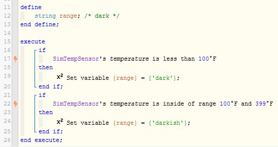

If you want the variable to be text (string), then this should work:
(Replace my “SimTemp’s temperature” with your “Device’s lux level”)
(import code: vzfe2)

One last thing, if you have a trigger in the piston, then the lightning bolts shown above will not be there for you, and the statements will be treated as conditions instead.
That’s still not a range, it’s a text string. You’re setting it to “light” or “dark”. I assumed when the OP said set a variable to a range, he/she then wanted to evaluate whether another number fell within that range, which you couldn’t do with a text string. In that case you’d have to use 2 variables, one for the high and one for the low.
