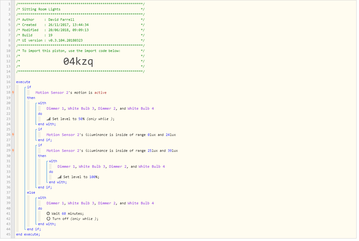

Setting a few scenes in Sitting Room Lights
Trying to setup 4 lights in Sitting room to cover a few scenarios.
a Few things.
1 - As these are on a manual switch that I cant remove due to risk of divorce. That if the switch is turned on and the room lux sensor is above 35 lux that the lights turn off again.
2 - If there is motion and the lux is above 35 the lights turn off
3 - If there is motion and the lux is between 17 and 35 the lights turn on to 50%
4 - If there is motion and the lux is between 0 and 17 the lights turn on to 100%
5 - If there is no motion for 60 minutes the lights turn off.
6 - And there is an over ride that if lights are set outside webcore (alexa or app) that the settings dont change but the timer works.
Lights turn on and stay on when the switch is turned on.
Motion turns on the lights to 100% and I tried but couldnt get the different lux settings to work . Lights were going up and down in brightness for no reason.
NOTE - I had to remove the test lines as my better half wasnt happy to have the lights changing.

  1. Your second if has no command to perform.
  2. What is happening is;
    If you move around motion triggers and sets light to 50 %. Then second if lux block changes it to 100%. Then when motion stops and goes inactive( you may still be in room) it turns off lights. You move again it sets lights to 50% then lux block change to 100%. And repeat
I would change
  1. the first if block to changes to active.
  2. Set a variable to occupied as true
  3. Set a restriction at the beginning to check if variable occupied is true
  4. Set a command for the first lux if block
  5. After you have the lights turn off set variable to false (maybe another if block if motion stays inactive for more than 5 minutes then turn off lights and set variable to false.) make it a top level check, by doing it this way you could remove the else block.
