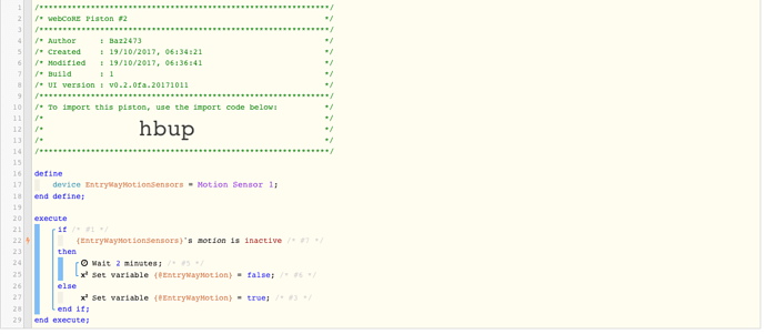

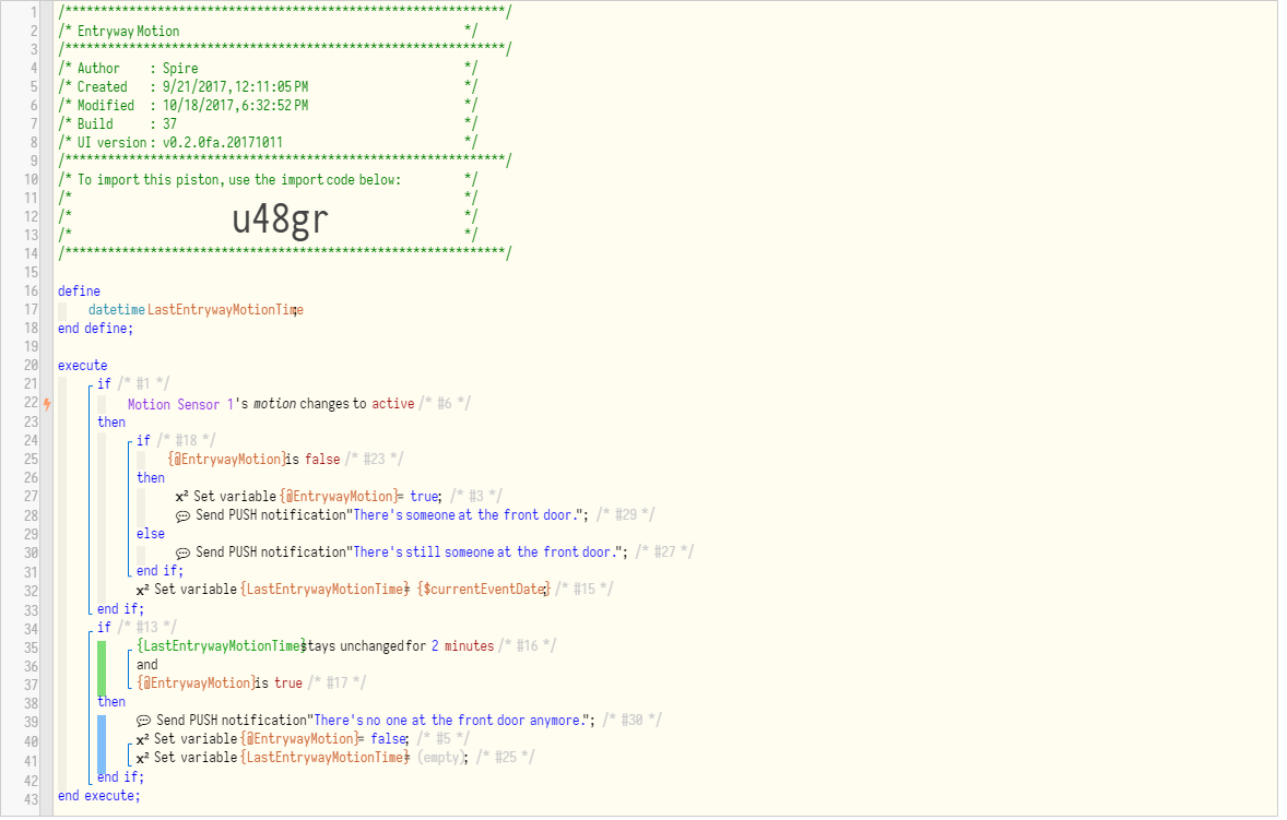

I am trying to write a piston that sets a global variable, @EntrywayMotion, to true whenever there has been any motion detected by the Entryway Motion motion sensor (anonymized in the snapshot as Motion Sensor 1) within the past two minutes, and to false otherwise.
I would like to accomplish this in the simplest and most efficient way possible.
The @EntrywayMotion variable should be set to true when there is motion, and then back to false exactly two minutes after the last motion has been detected.
The @EntrywayMotion variable is correctly set to true when there is motion, but it is set back to false two minutes after the motion sensor first becomes inactive, rather than two minutes after the last motion has been detected.
10/18/2017, 6:50:18 PM +359ms
+1ms ╔Received event [Home].time = 1508377819525 with a delay of -1166ms
+165ms ║RunTime Analysis CS > 12ms > PS > 78ms > PE > 74ms > CE
+181ms ║Runtime (41308 bytes) successfully initialized in 78ms (v0.2.0fa.20171011) (178ms)
+182ms ║╔Execution stage started
+201ms ║║Cancelling condition #16's schedules...
+202ms ║║Condition #16 evaluated true (2ms)
+207ms ║║Comparison (boolean) true is (boolean) true = true (2ms)
+209ms ║║Condition #17 evaluated true (7ms)
+210ms ║║Cancelling condition #13's schedules...
+211ms ║║Condition group #13 evaluated true (state changed) (11ms)
+213ms ║║Cancelling statement #14's schedules...
+235ms ║║Executed virtual command sendPushNotification (17ms)
+238ms ║║Cancelling statement #31's schedules...
+241ms ║║Executed virtual command setVariable (1ms)
+246ms ║║Executed virtual command setVariable (3ms)
+249ms ║╚Execution stage complete. (68ms)
+332ms ╚Event processed successfully (332ms)
10/18/2017, 6:49:50 PM +625ms
+1ms ╔Received event [Entryway Motion].motion = inactive with a delay of 502ms
+151ms ║RunTime Analysis CS > 12ms > PS > 67ms > PE > 71ms > CE
+166ms ║Runtime (41310 bytes) successfully initialized in 67ms (v0.2.0fa.20171011) (164ms)
+177ms ║║Comparison (enum) inactive changes_to (string) active = false (0ms)
+178ms ║║Cancelling condition #6's schedules...
+179ms ║║Condition #6 evaluated false (6ms)
+180ms ║║Cancelling condition #1's schedules...
+181ms ║║Condition group #1 evaluated false (state changed) (8ms)
+186ms ║║Comparison (datetime) 1508377771801 stays_unchanged = true (1ms)
+188ms ║║Condition #16 evaluated false (5ms)
+189ms ║║Condition group #13 evaluated false (state did not change) (5ms)
+191ms ║╚Execution stage complete. (24ms)
+193ms ║Setting up scheduled job for Wed, Oct 18 2017 @ 6:50:19 PM PDT (in 28.708s)
+217ms ╚Event processed successfully (216ms)
10/18/2017, 6:49:32 PM +110ms
+2ms ╔Received event [Entryway Motion].motion = active with a delay of 309ms
+190ms ║RunTime Analysis CS > 15ms > PS > 101ms > PE > 74ms > CE
+206ms ║Runtime (41314 bytes) successfully initialized in 101ms (v0.2.0fa.20171011) (203ms)
+207ms ║╔Execution stage started
+217ms ║║Comparison (enum) active changes_to (string) active = true (1ms)
+219ms ║║Cancelling condition #6's schedules...
+219ms ║║Condition #6 evaluated true (7ms)
+220ms ║║Cancelling condition #1's schedules...
+221ms ║║Condition group #1 evaluated true (state changed) (9ms)
+227ms ║║Comparison (boolean) true is (boolean) false = false (2ms)
+228ms ║║Condition #23 evaluated false (5ms)
+229ms ║║Condition group #18 evaluated false (state did not change) (6ms)
+231ms ║║Cancelling statement #26's schedules...
+242ms ║║Executed virtual command sendPushNotification (7ms)
+245ms ║║Cancelling statement #2's schedules...
+250ms ║║Executed virtual command setVariable (3ms)
+256ms ║║Comparison (datetime) 1508377771801 stays_unchanged = true (1ms)
+258ms ║║Condition #16 evaluated false (4ms)
+258ms ║║Condition group #13 evaluated false (state did not change) (5ms)
+261ms ║╚Execution stage complete. (55ms)
+263ms ║Setting up scheduled job for Wed, Oct 18 2017 @ 6:50:19 PM PDT (in 47.153s)
+287ms ╚Event processed successfully (287ms)
10/18/2017, 6:48:19 PM +297ms
+1ms ╔Received event [Entryway Motion].motion = inactive with a delay of 304ms
+188ms ║RunTime Analysis CS > 15ms > PS > 103ms > PE > 70ms > CE
+206ms ║Runtime (41311 bytes) successfully initialized in 103ms (v0.2.0fa.20171011) (203ms)
+218ms ║║Comparison (enum) inactive changes_to (string) active = false (1ms)
+219ms ║║Condition #6 evaluated false (6ms)
+220ms ║║Condition group #1 evaluated false (state did not change) (7ms)
+225ms ║║Comparison (datetime) 1508377681972 stays_unchanged = true (0ms)
+227ms ║║Adding a timed trigger schedule for condition 16
+229ms ║║Cancelling condition #16's schedules...
+230ms ║║Condition #16 evaluated false (7ms)
+231ms ║║Cancelling condition #13's schedules...
+232ms ║║Condition group #13 evaluated false (state changed) (9ms)
+234ms ║╚Execution stage complete. (28ms)
+236ms ║Setting up scheduled job for Wed, Oct 18 2017 @ 6:50:19 PM PDT (in 119.993s)
+265ms ╚Event processed successfully (265ms)
10/18/2017, 6:48:02 PM +260ms
+1ms ╔Received event [Entryway Motion].motion = active with a delay of 288ms
+271ms ║RunTime Analysis CS > 13ms > PS > 195ms > PE > 63ms > CE
+353ms ║Runtime (41310 bytes) successfully initialized in 195ms (v0.2.0fa.20171011) (350ms)
+353ms ║╔Execution stage started
+363ms ║║Comparison (enum) active changes_to (string) active = true (1ms)
+365ms ║║Cancelling condition #6's schedules...
+365ms ║║Condition #6 evaluated true (6ms)
+366ms ║║Cancelling condition #1's schedules...
+367ms ║║Condition group #1 evaluated true (state changed) (8ms)
+372ms ║║Comparison (boolean) false is (boolean) false = true (1ms)
+373ms ║║Cancelling condition #23's schedules...
+374ms ║║Condition #23 evaluated true (5ms)
+375ms ║║Cancelling condition #18's schedules...
+376ms ║║Condition group #18 evaluated true (state changed) (7ms)
+378ms ║║Cancelling statement #19's schedules...
+381ms ║║Executed virtual command setVariable (1ms)
+383ms ║║Cancelling statement #28's schedules...
+394ms ║║Executed virtual command sendPushNotification (7ms)
+397ms ║║Cancelling statement #2's schedules...
+402ms ║║Executed virtual command setVariable (3ms)
+408ms ║║Comparison (datetime) 1508377681972 stays_unchanged = true (1ms)
+409ms ║║Adding a timed trigger schedule for condition 16
+411ms ║║Cancelling condition #16's schedules...
+412ms ║║Condition #16 evaluated false (7ms)
+413ms ║║Cancelling condition #13's schedules...
+414ms ║║Condition group #13 evaluated false (state changed) (9ms)
+416ms ║╚Execution stage complete. (63ms)
+418ms ║Setting up scheduled job for Wed, Oct 18 2017 @ 6:50:02 PM PDT (in 119.993s)
+439ms ╚Event processed successfully (439ms)
