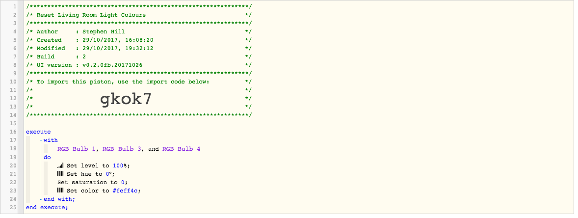

Prior to creating this piston I recorded what the settings were in IDE and my goal was to create a piston which ‘reset’ 3 bulbs to their previous accepted colours. However, when doing this via WebCore, the variables were different. The bulbs are Osram RGB Lightify ones if that helps?
I essentially just want the bulbs to be set to the settings I put into my WebCore piston.
Completely different settings after running the piston:
RGB Bulb 1 =
switch: on
level: 100
hue: 17
saturation: 100
color: #FFFFFF
RGB Bulb 3 =
switch: on
level: 100
hue: 17
saturation: 100
color: #FEFF4C
RGB Bulb 4 =
switch: on
level: 100
hue: 17
saturation: 100
color: #F5FF25
Anyone have any idea here - I’m really clutching at straws! I’m using the ZigBee RGB Bulb device handler if it helps?
Just guessing here that when you set the Color it overrides your HSL values. According to color picker I plucked out of google #f5ff25 == 63,100,57 HSL

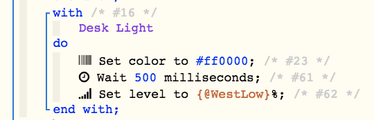

Is anybody else having trouble with Osram Lightify bulbs where you set level but it never makes it all the way to the level you set? Is this the same problem as above?
I’m seeing behaviour like:
bulb at level 60
my webcore piston issues set level 30
bulb ends up at level 52 or 38 or 49 etc…
I thought blasting it with the correct set level command might help but it doesn’t.
Do you have an image of the code that sets the levels.
I think I figured it out. Seems like the device can’t handle 2 simultaneous commands. If I put this 1/2 sec (could be less haven’t tried) wait in there, it works as expected.
