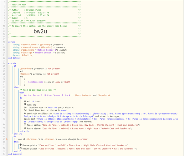

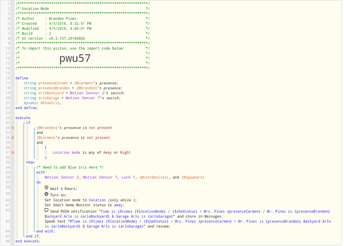

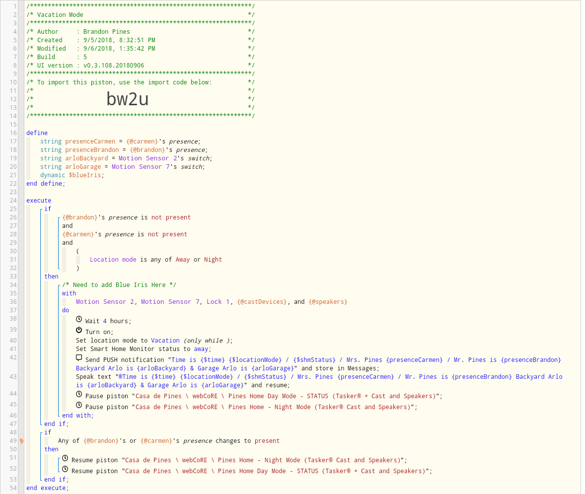

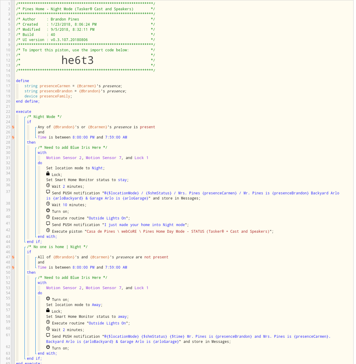

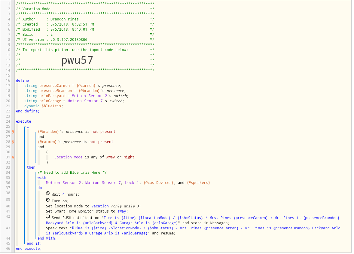

1) Give a description of the problem?
I would like my 1st and 2nd piston to pause when no one is home and away has been on for four hours (which is the third piston). I would like it to unpause when someone arrives home.
See above
Not sure how to tie these all together.
