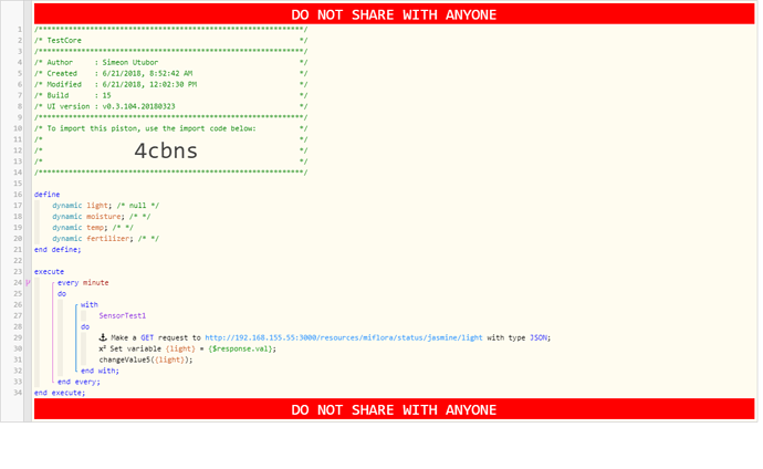

I am trying to hit an API with a GET, and set the response.val as a variable to be displayed, but I’m getting null values.
Have the $response.val be set to a variable after calling it.
Variable remains as null
(UPLOAD YOUR IMAGE HERE)
Image: https://ibb.co/h8pULT

Try
And change your get request to type json
I changed it to such, and still null.
I changed the request a bit, but I’m still having the same issue :frowning:

Try removing the .val part of the $response. See if that populates anything to your variable.

Would you please try adding some lines in here to check specifics of the response? Use the Log to console action to check the following:
