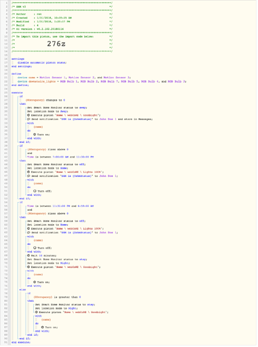

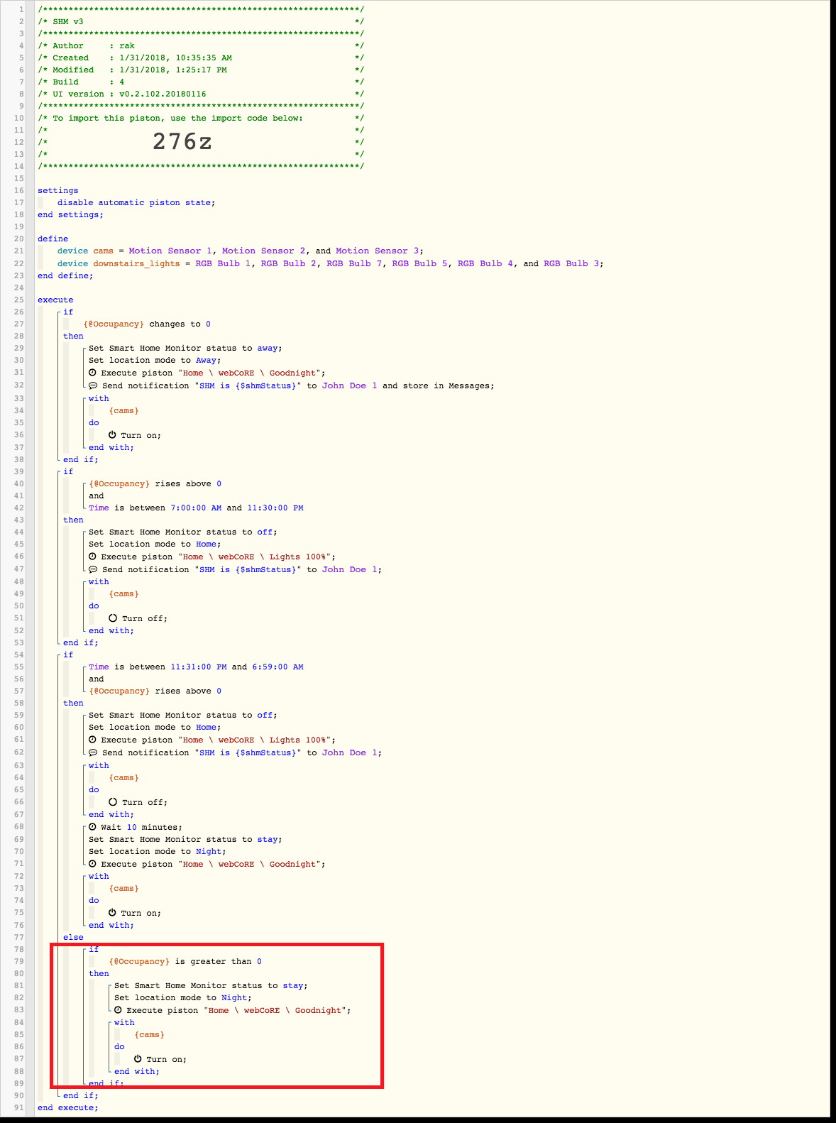

I’m trying to re-do my SmartHome Monitor piston. I’m triggering alarms if I come home after 11:30pm.
I’m trying to build the following logic:
If it’s 11:30pm and the wife and I are both home, set SHM to armed/home
If it’s AFTER 11:30pm and we arrive home, then it should disarm for a time and change back to armed/home.
I guess I’m trying to figure out if the logic in this piston will work correctly. Specifically I’m getting confused on how the length of time will evaluate between “presence sensor changes” and “presence sensors are present”
Maybe there’s a better way to do it?
