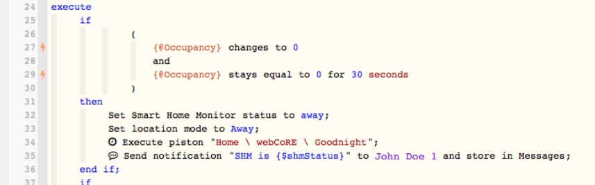

No, I didn’t get a chance to login and take a look. But I added a sanity check which I think might help:
Added the “stays equal to 0 for 30 seconds”… Do you see anything majorly wrong with adding that?
I think you just need the second statement. Since one will create a 30 second delay, they’ll never both be true at the same time.
